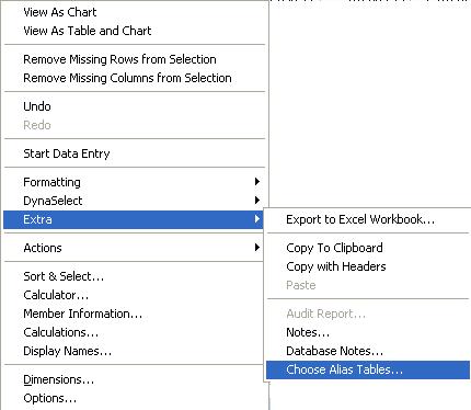

Right click in the on the view and the click on Extra -> Choose Alias Tables
Please see the attached screen shot for details
- Using TM1 Aliases in Executive viewer
- EV_UsingTM1Aliases.JPG (26.25 KiB) Viewed 6194 times

Re: EV support for aliases
It seems as though we have a 2 year echo ....rkaif wrote:Right click in the on the view and the click on Extra -> Choose Alias Tables
The original post also said exactly that and was referring to a bug in that feature with an older version of EV
ScottW wrote:I'm using EV vers 9.3.1 and have noticed that support for element aliases (right-click > Extra > Choose Alias Tables) has a definite bug ...
