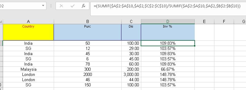

I got a requirement of SUMIF calculation to be done in TI process as below ,
For Eg:
Column A | Column B | Column C | Column D
India | 5 |10 | Calculated Value
SG | 10 | 20 | Calculated Value
SG | 10 | 25 | Calculated Value
India | 45 | 15 | Calculated Value
Column D(Calculation formula)
=(SUMIF($Column A$1:$Column A$4,Column A,$Column B$1:$Column B$4)/SUMIF($Column A$1:$Column A$4,Column A,$Column C$1:$Column C$4))
I understood that the result should be,
India ,50 / India , 25 = Value
SG , 20 / SG , 45 = Value
India = 2
SG = 0.44
Kindly suggest me to achieve in TI Process calculations.
TIA

Re: Excel SumIF in TM1
Posted: Wed Aug 05, 2020 10:07 am
by AlphaWay
All columns mentioned are from same "Measure" dimension .
Scenario
Scenario
Sum If function inside TI process is not working.
Inv % column is my result column and mentioned formula is the one i am trying out.
