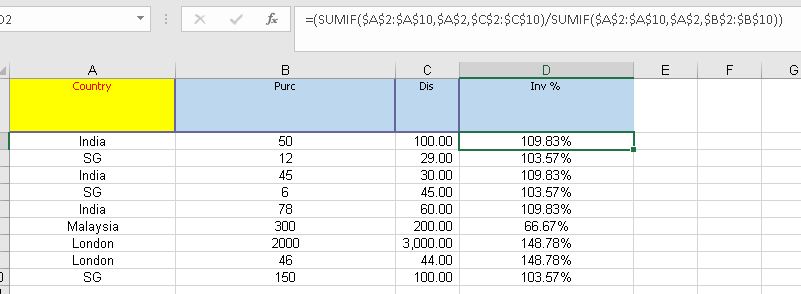

AlphaWay
Posts: 11
Joined: Wed May 20, 2020 6:23 am
Excel Version: Version 2003
Re: Excel SumIF in TM1
Post by AlphaWay »
All columns mentioned are from same "Measure" dimension .
Scenario
Scenario
Sum If function inside TI process is not working.
Inv % column is my result column and mentioned formula is the one i am trying out.
TIA,
Wayfarer
