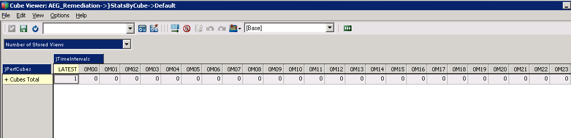

thanks every1 for your valuable reply. Really i got my most of queries solved. Now i created a TI Process and inside it i called ViewConstruct function for all 10 cube whose views are taking good time to open. Can any one help me how to check if my stargate views is created or not?? I have set vmt as 3 and vmm as 30 for a cube for which i am trying to create stargate. Still i am not able to find that stargate view is created or not. for reference i am attaching screen shots
Re: STARGATE VIEWS CREATION
zodiacviv wrote:Can any one help me how to check if my stargate views is created or not??
Did even take the time to read all the posts in this thread? If you set the logging properties as mentioned above, the creation of stargate views will be logged in the tm1server.log file.

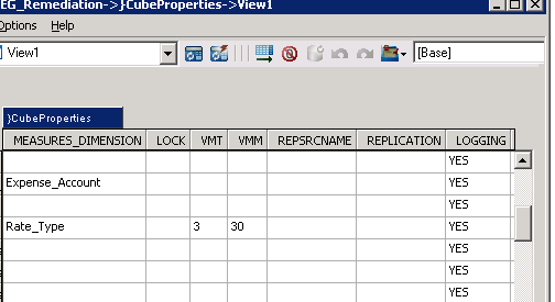

and vmm as 30
Also, from further up the thread, 30 (30kb) is too low for any useful views.
