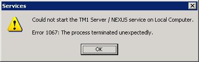

TM1 Server as Service
Can anybody help me out? I'm a newbie on TM1 rather than starting TM1 server as an application...I'm having a problem starting the TM1 as a service. I attached the error I got when I started the service? Is there any configuration required in TM1? or on the Windows Server?
- TM1 Service Error.JPG (10.05 KiB) Viewed 14903 times
- Posts: 6672
Re: TM1 Server as Service
I'd check the error logs on the Windows server. You'll probably find an entry in the application log which gives you more information about why it stopped.appleglaze28 wrote:Can anybody help me out? I'm a newbie on TM1 rather than starting TM1 server as an application...I'm having a problem starting the TM1 as a service. I attached the error I got when I started the service? Is there any configuration required in TM1? or on the Windows Server?
(Edit: Right click on "My Computer", select Manage, then Event Viewer, then Application.)
However I can make an educated guess.
Most likely, you have invalid entries in your tm1s.cfg file (or no file at all). When you installed the service (whether through Windows or through the TM1 installation process) you would have had to specify the data directory. This directory is sometimes also specified in the .cfg file. (Can't recall whether it's required or not.) If you've copied the data folder from another installation it's possible that the .cfg file has an obsolete data directory path in which case the application error will be something like "Cannot find data directory". Alternatively you may have an invalid log file path specified. It's possible that you have an invalid port number specified, but usually when that happens the server session just doesn't appear in server explorer even though it does start.
There could be a bunch of reasons, but odds are that the reason is somewhere in the .cfg file.

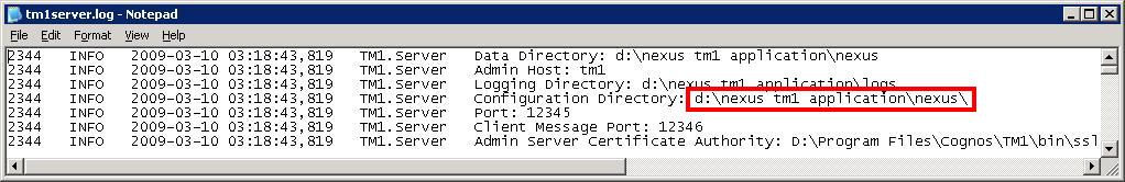

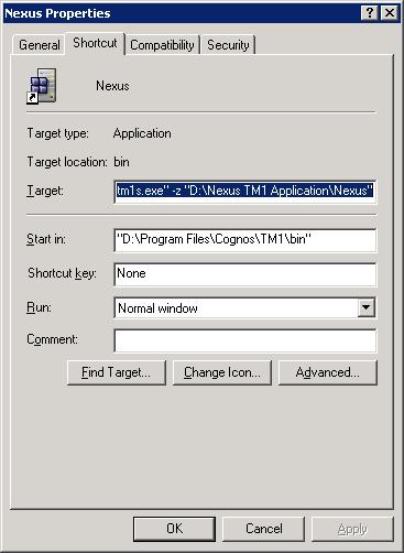

I tried rechecking the path in the .cfg file against the log & the shortcut and its still the same. I'm not really sure what the problem is cause even the server admin himself couldnt make it run.
- Screenshot of the shortcut properties
- ShortCut.JPG (30.07 KiB) Viewed 14782 times

- Posts: 6672
But have you looked at the applicatiion log in Windows?appleglaze28 wrote:I tried rechecking the path in the .cfg file against the log & the shortcut and its still the same. I'm not really sure what the problem is cause even the server admin himself couldnt make it run.

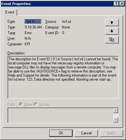

I'm not sure what the error means.
- Windows Log.JPG (36.33 KiB) Viewed 14779 times
- Posts: 6672
Hmmm, "Data directory not specified", you say?appleglaze28 wrote:I'm not sure what the error means.
I think it means that you shouldn't use spaces in your folder names.
Remember how I told you that is was most likely a problem with your data directory specification?
And you know how some people hate to say I told you so?
Not me.
I told you so.
I don't know how you installed the service (that is, whether you did it as a "Custom" server via the installation package or whether you used the tm1sd.exe -install command line). What I do know is that either way you would have had to specify a data directory, whether through a dialog box or a command line argument. However you did it, my guess is that the path wasn't registered correctly and the reason that it didn't register correctly is because you have spaces in your file path.
To fix this, I suggest the following:
- Uninstall the service. You'll find instructions for doing this under the Help topic "Setting Up a Remote TM1 Server to Run as a Windows Service" in the Operations guide.
- Get rid of the spaces in your path names. Just because the O/S lets you do something (or sometimes lets you do something if it feels like it) doesn't mean that you should actually do it. Use of anything other than alphanumeric and underschore characters in system object names (including folders) is a prime example of this. (Yes, I know that Microsoft did it with the "Program Files" folder. Yes, the MS 'droid who came up with that idea should be thunked upside the head daily with a large, frozen salmon.)
- Edit your TM1s.cfg file to change the DatabaseDirectory parameter to the new, no-spaces file path. Do the same with the LoggingDirectory parameter if you use it.
- Reinstall the service using the new path, again using the instructions in the Help topic specified above.

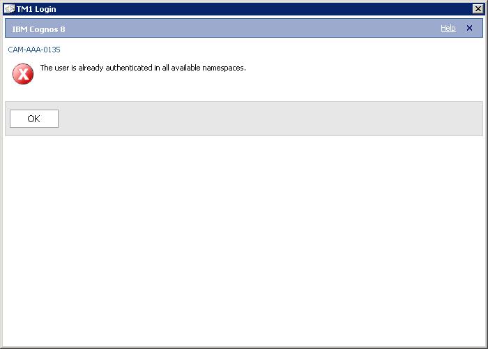

Has anyone of you have a Cognos BI and use its security than using TM1's own user and is runnin TM1 as a service.
This is my first time to run TM1 as a service and I'm having problems when it comes to logging in. Since before once I log out I can log in again but now when I log out I need to close Architecture or Perspective (Excel) totally before loggin in again if not I'll encounter a problem.
I never encountered when TM1 was still an appliation server.
- TM1 Login Error.JPG (22.14 KiB) Viewed 14707 times
- Steve Vincent
I've only seen the cognos front end as a demo but i seem to remember that although they had intentions to fully administrate TM1 via Cognos BI, i don't think they had done it all. Might be worth checking but maybe you need to do stuff like that directly in TM1 for now?
As for not logging you out, that sounds like and issue between the 2 sets of software. if you close perspectives it won't log you out as its resident in Excel, its sounds like a similar thing is happening when you issue the logout command to BI. Probably worth speaking to your Cognos / IBM rep and possibly log a fault with them.
Its just that before when I connected TM1's security through Cognos BI's portal...it was working when TM1 was still a application server. Now that its a service I'm encountering lots of issues like any security I got from Cognos BI, When I log out all the security setting for that name that isnt 1 of the 3 admin roles disappear. So technically if I have 10 users all of them wont be able to view any cube unless they are admins
- Posts: 6672
I can't speak to Cognos BI since I don't use it, but there is one thing to consider; which is what login the services are running under.appleglaze28 wrote:Its just that before when I connected TM1's security through Cognos BI's portal...it was working when TM1 was still a application server. Now that its a service I'm encountering lots of issues like any security I got from Cognos BI, When I log out all the security setting for that name that isnt 1 of the 3 admin roles disappear. So technically if I have 10 users all of them wont be able to view any cube unless they are admins
When we were running our servers as applications, they were running under an administrator account.
If you look at the list of Services in the Computer Management console dialog in Windows, you'll see "Log On As" as one of the columns.
If you use the tm1sd -install method WITHOUT using the optional -u and -w parameters to pass the user name and password, then the service is likely to be installed to log on as "Local System".
I made that mistake with one server and while the server ran fine normally, I encountered errors when it tried to write ASCIIOutput data to a shared folder on another box.
The reason was that the LocalSystem logon didn't have the same network permissions as the administrator account did.
In other words, make sure that the Log On As column shows the same account name that you were using to run the server as an Application. If it doesn't, you could well have a permissions issue. Uninstall (Remove) the service, and reinstall it including the -u and -w parameters (which are listed in the help file article that I referred to earlier in this thread.) That may solve the problem.
As I said I can't guarantee it since I don't know how BI's security model works, but it's worth taking a look at.
