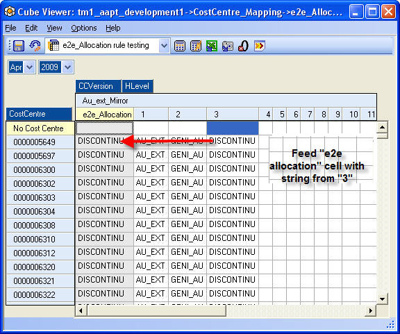

Need some help. I am trying to keep some cells fed with a sting in a particular location ( screenshot below ).
The calculation appears to work, but when I go to try and feed the area i wish to feed when i suppress my zeros ( in the
cube viewer) the cells
are not kep open...which means that the cells are not being fed...I have tried feeding the cells using the "FEEDSTRINGS"
declaration ( where should i put this.. is it after FEEDERS??) instead of the "FEEDERS" declaration but it does not like it. Any reasons as to why this would not work?? The value in the cube is a string value deifined by a string measure called "au_ext_mirror"
Thanks again, Shock.

Screenshot of cube:
