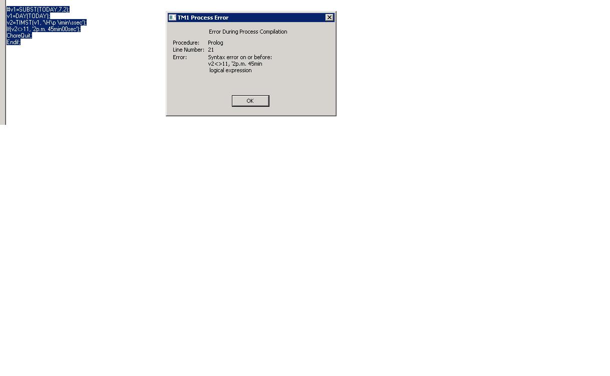

I'm trying to quit a chore when a condition of combination of date/time is achieved. To do this, I'm using the TIMST function. The code I added in the Prolog tab is -
#v1=SUBST(TODAY,7,2);
v1=DAY(TODAY);
v2=TIMST(v1, '\H\p \imin\ssec');
If(v2<>11, '2p.m. 45min00sec');
ChoreQuit;
Endif;
However, I'm getting the error as attached -
Can somebody please let me know the issue with my syntax here? I'd appreciate your time and efforts.
Error on compiling the process

I can honestly assure you, it helps to press F1 in a Turbo Integrator process, and search for Timst.
If you would do that, you could see that Timst returns a string.
Hence, among other things, <> will need to be replaced with @<> in your comparison.
Did you check the popup with the error? It's usually (not always) helpful.

Thanks Wim for the reply. I did try adding @<> before posting this thread. However, even that throws an error - 'Incorrect logical comparison'. To convert all the parameters within the If condition to string, I did try substituting v1 as 'v1=SUBST(TODAY,7,2);' as I assume this would return a string value as compared to 'v1=DAY(TODAY);' which would return a numeric. The updated code I tried was as below -
#v1=DAY(TODAY);
v2=TIMST('v1', '\H\p \imin\ssec');
If(v2@<>11, '2p.m. 45min00sec');
ChoreQuit;
Endif;
Despite this, the process throws error.

First, you're comparing v2 (which, as Wim noted, returns a string) with a numeric value, not a string.
Second, I'm not sure what you're expecting the second argument of your If() statement to do but in this context (there are two permutations of If() in TI (the TI flow control block and the Rules function) and this is neither of them) it requires one argument not two, and the argument needs to evaluate to either True or False.

Post by Duncan P »
So the numeric comparison is not the only problem.
IF has two forms
IF ( condition );
ENDIF;
and
var = IF( condition, value_if_true, value_if_false );
You have something between with
IF( condition, string );
ENDIF;
However thinking laterally it is possible that you meant
IF( v2 @<> v1 | '2p.m. 45min00sec');
where the | is the string concatenation operator and you use v1 instead of 11.
