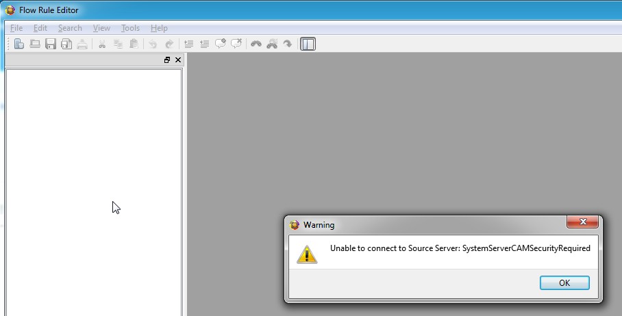

I want to try it but does it work with Cam security? I get the next message when I want to log in.
ScreenHunter_92 Dec. 09 16.24.jpg (32.7 KiB) Viewed 31534 times

I haven't been able to test here yet, but I'm pretty sure CAM security is unsupported in this initial release.

Any updates on when you are planning make CAM security compatible ? Unless the editor connects through CAM not many developers can really use it. we love the tool but can't use it.
