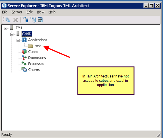

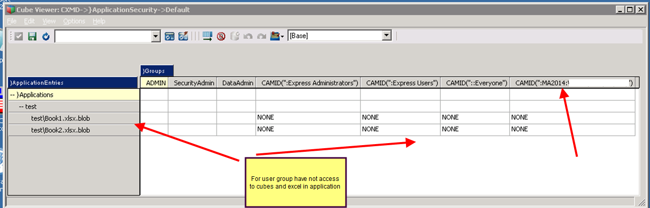

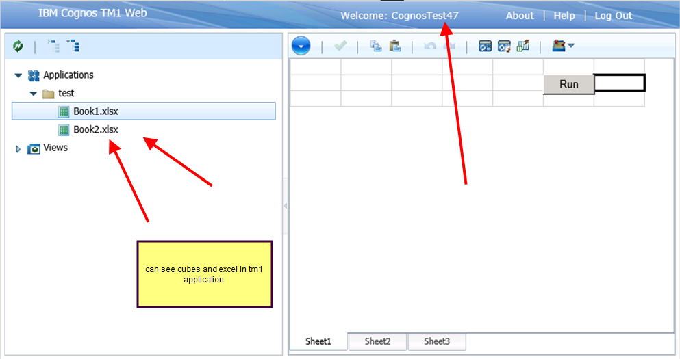

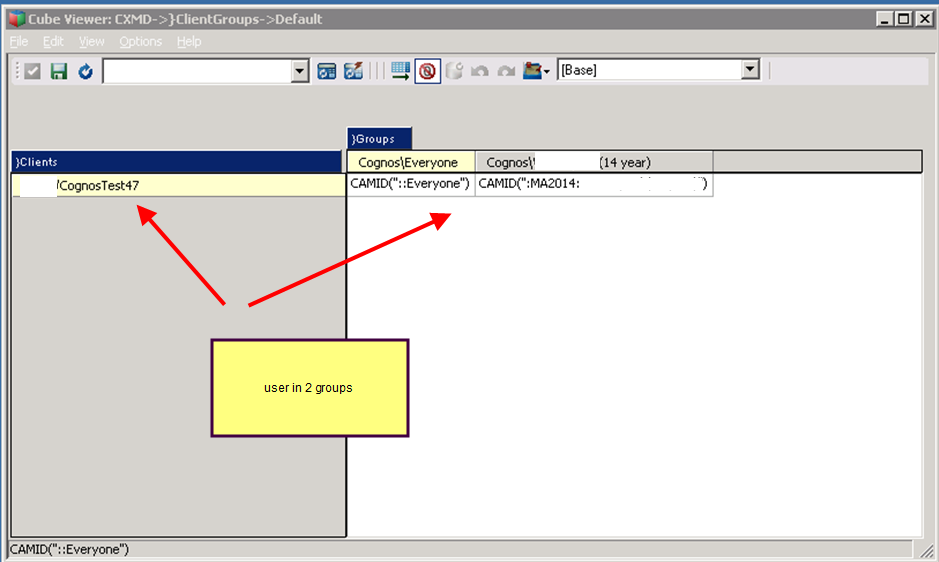

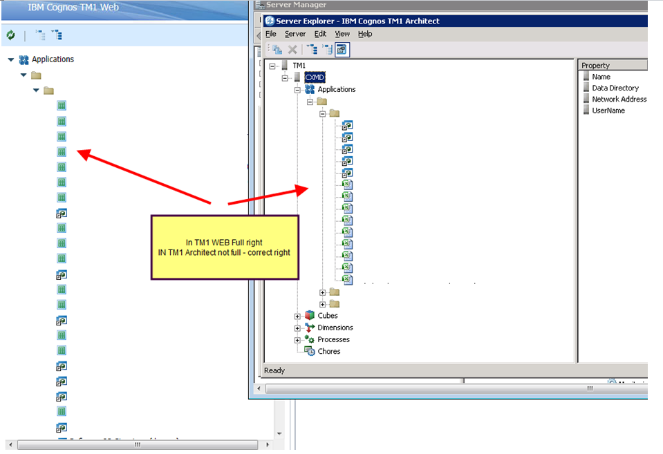

The user has access rights to not all objects (cubeview and excel websheets) in application in tm1web
But user see ALL tm1 cubeview and excel websheets in application in tm1web .This is wrong.
In TM1 Architect user see cubeview and excel websheets in application In accordance with his rights. This is correct
