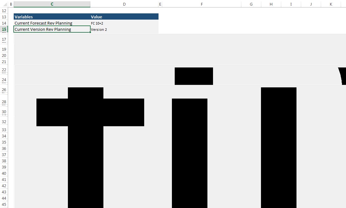

I have an issue with action buttons in Excel (tm1 10.2 and Excel 2013). When I make a sheet in excel on the server (Regional settings EN, Decimal Symbol [.], Digit Grouping Symbol [,]) and open on a workstation (Regional settings NL, Decimal Symbol [,], Digit Grouping Symbol [.]) the action buttons get realy big (see attached picture).
ScreenHunter_64 Nov. 26 08.28.jpg (38.77 KiB) Viewed 3321 times
I have tested somewhat and it seems the font size is the problem here. The font size is probably set to 9.75 (or 9,75), when it's converted to the other settings the font size goes to 975 (assumed this is it, because I can see the size is 975 when converted, when not converted the size is presented as 10, but this can be a rounded number) .

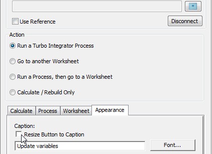

Another solution is to not set 'resize Button to caption';
ScreenHunter_66 Nov. 26 09.50.jpg (23.15 KiB) Viewed 3321 times
But then you get a button without text, or better, not visible text.
