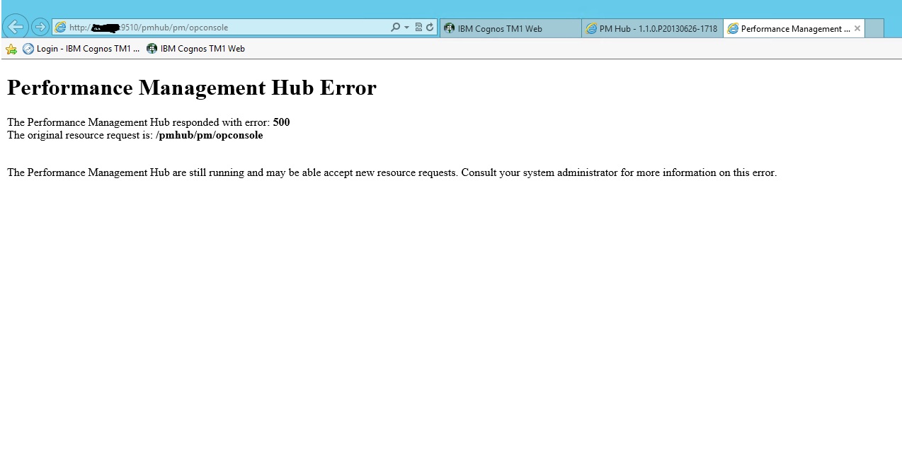

After instaling tm1 10.2 on the clients server (win server 2012) and trying to open ops console I get following error:
Oddly enough I had no trouble opening ops console after installing tm1 10.2 on win 2012 on my laptop VM. I didnt have to do anything, but edit .xml file with all the set up parameters. It worked as expected

In the original message you've got the URL wrong. You've typed opconsole rather than opsconsole (missing the s).
The message is from pmhub saying it can't find the resource /pmhub/pm/opconsole which is right, it isn't there. /pmhub/pm/opsconsole should work fine.

Oh, stupid me !!!! :oops: :oops: :oops: :oops:
Thanks mate for opening my eyes lol
