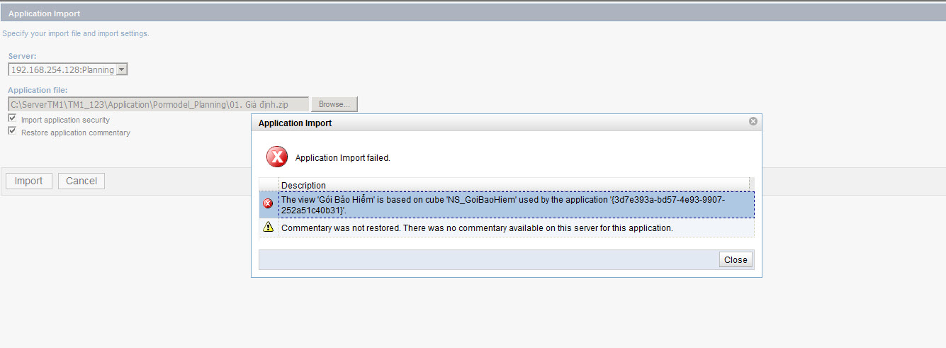

Hi everyone,
I'm export applcation in contributor version 10.1.1. After i'm import application in contributor version 10.2 but i can't not...
thanks all

Run the }tp_admin_delete_all process and try to import again.
Regards Sander

assuming that you are upgrading and don't have any apps yet in the new environment

Thanks your ver much,
I solved problem, i copy applications in folder TM1 .
