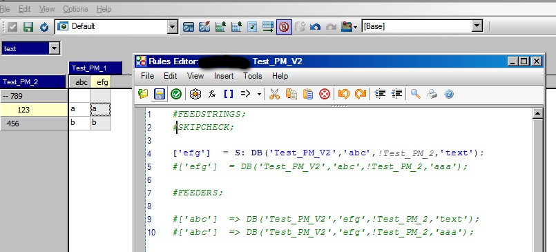

Could you help to explain whey the string value in 'efg' coming from 'abc' can still be shown correctly even if I suppressed zeroes and cells are not fed in the view according to current rule?
Re: Question for Feedstrings
Because feeders don't go away just because you've commented them out in the code. Recycle the service and see if they still appear after a zero suppress.

tomok wrote:Because feeders don't go away just because you've commented them out in the code. Recycle the service and see if they still appear after a zero suppress.
It is still there after restarting the server or unloading the cube.

Because SKIPCHECK is commented and TM1 analyses every cell of your cube

Elessar wrote:Because SKIPCHECK is commented and TM1 analyses every cell of your cube
Thanks, you are right. My mistake. :ugeek:
