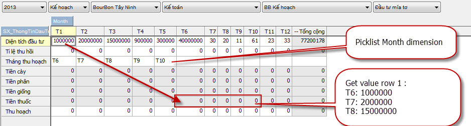

Hi everyone,
I have Cube get value the same image
How can do ?? I using rules
Thansk all
Get Value from month to month

Also, I cant really tell what is your application meant to do, but it seems to me that current rule/cube design is not optimal/hard to use given there are 8 dimensions in the cube. I would rather have a satellite cube that drives the "slider".

['DT08']=N:IF( DIMIX('Month',ATTRS('Month',!Month,'VN')) = DIMIX('Month',DB('SX_DienTichDauTu',!Year,!Version,!CongTy,!PhongBan,!Level_SanXuat,!SX_LoaiDauTu,!Month,'DT02')),1, 0 );
When i try
['DT08']=N:IF( DIMIX('Month',ATTRS('Month',!Month,'VN')) =9),
1, 0); It okie
This is my rules. Result all zeroEvgenyT wrote:The obvious thing: the rule inst working...
When i try
1, 0); It okie

Sorry, but I don't think this rule relates to what you were trying to achieve above.This is my rules. Result all zero
When i try
1, 0); It okie
