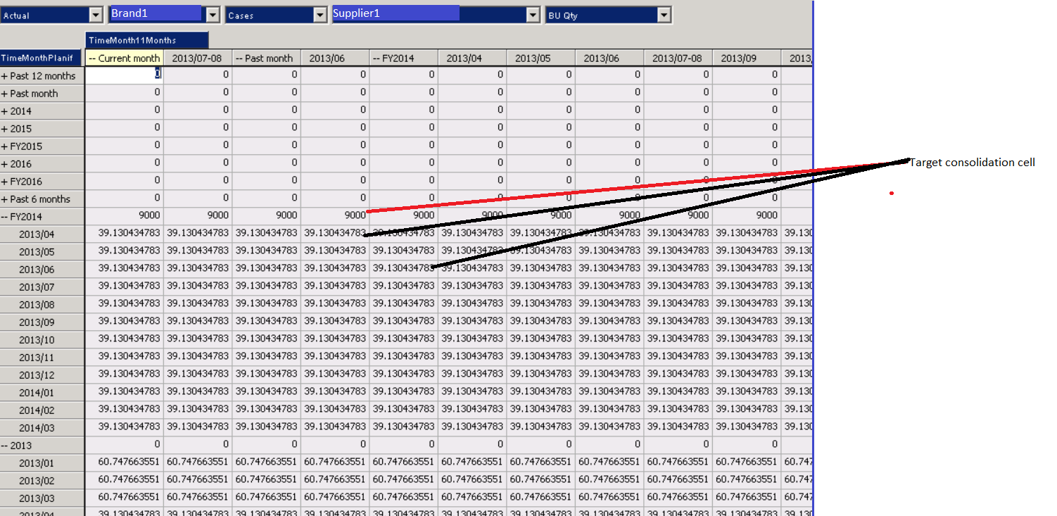

Thanks for helping me. I have attached to this post a screenshot of both our source and target cubes. On the target cube,
if I select any of the cell containing 9000, I will get the unfed status. As you can see, our rule writes the same value in all the TimeMonth11Months elements (the reason is that we have only one version of our Budget 2014, so it does not matter from which month we observe it).

In the source cube: Consider putting this feeder in and let me know if it works: The dim order might not match (since I dont know the dim order in your target cube ,or its name)
['BU Qty'] => DB ( 'TGT_Cube' , 'Actual', !Brands, !Components, !Providers, 'FY' | SUBST(!TimeMonth11Months , 6, 4), 'FY' | SUBST(!TimeMonth11Months , 6, 4), 'BU Qty' );
The idea is
  • Pull out a substring '2014' from 'DI_FY2014' from the 'TimeMonth11Months' dimension.
  • Prefix 'FY' to the year we pulled out... 'FY2014'.
  • Feed to the consolidation element 'FY2014': This feeds the consolidation and all its children.

Wouahhh it works!
I have to say I understand the first "'FY' | SUBST(!TimeMonth11Months , 6, 4)" which makes sense to me. But not the second one, which matches the TimeMonth11Months dim. Your feeder doesn't address specifically the DI_FY.... elements, but all elements. Does it mean that feeders do not need to match directly the rules logic? I guess this is what you wanted to say in your first reply.
