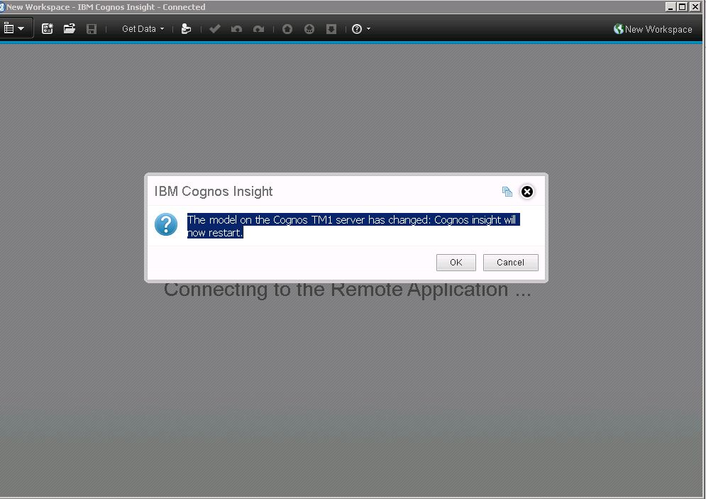

We`ve installed the IF1.
cognos security
1. when starting a node form a PM created application (approval) we get this in a loop.
have tried to force downgrade version on both CI and PM but still the same.
Application web client works.
