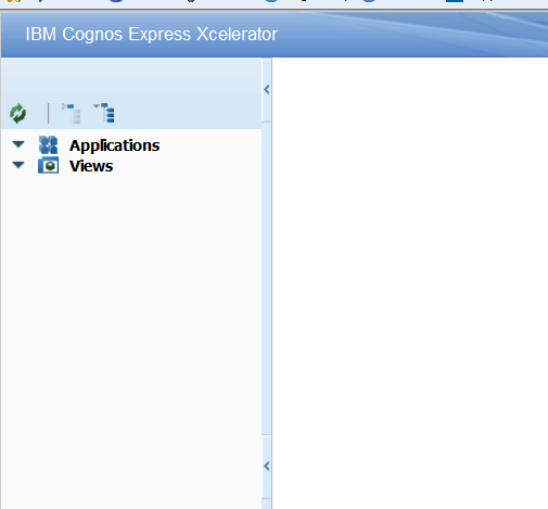

I'm experiencing and issue with TM1Web, after logging in (even as admin) I can't see any objects such as views or applications...
Would anyone know what could be causing this issue?
I'm using CAM ID autentification ( IntegratedSecurityMode=5)
Tm1Web, can't see any TM1 objects after logging in

I'm definitely connected to the server but I can't see the admin icon or anything else.
I haven't worked with Tm1Web much so I'm not quite sure what the issue is....

Looks like you have logged in as a Non Admin user with no access to objects, if you were logged in as admin then you would see the Administration grouping under Views
Check Security within Cognos Express Manager > IBM Cognos Administration > Security
Is it possible to change Integrated Security to 1 temporarily to test that works before then resolving with CAM?
