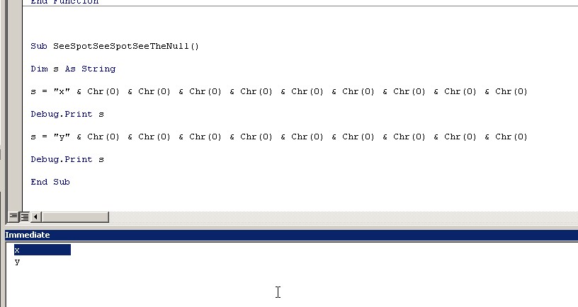

As for the absence or presence of nulls, I was going to demonstrate an example of what gets returned, but I can't run the actual code again until tomorrow and I don't have time to put together demonstration code. Except this. The procedure shown in the attached graphic was run twice.
Do you see any null characters? No, because they don't show up in the Immediate window.
Are they there? If the code itself doesn't convince you, you may wonder what all that empty space at the end of the first output line is.
They're there. And you use them to trim the return value, provided that you make sure that the return variable has a nice, blank space to write into.
- NullsArentVisibleInImmediateWindows.jpg (42.65 KiB) Viewed 14970 times

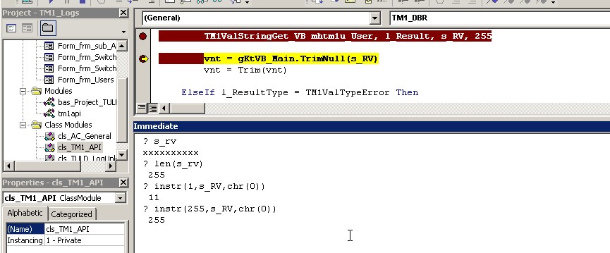

Re: The TM1 API - VBA
This is a "just for the sake of completeness" thing in case anyone (possibly me, in which case "hi" to me) is looking up this thread at some future time...Alan Kirk wrote:The fact that I used a string which was already 255 characters in size meant that mine probably didn't need null padding either (out of curiosity I'll check that when I run the program tomorrow), and the standard Trim() function was also part of my TrimNulls function which would get rid of the surplus spaces.
The TM1ValStringGet_VB function did in fact pad out all of the passed string with null characters beyond the actual content. The content of the cell that was read was 10 characters long. (I've had to x out the returned characters in the screen shot for confidentiality reasons.) The first null character was found at position 11, and there was also a null at position 255; although I didn't test all of the characters in between, it's a pretty fair bet that they were all nulls as well. As previously noted they don't show up in the Immediate window, but you can see a whole bunch of little square "control code" characters when you look at the variable contents via a tooltip.
- PaddedNulls.jpg (71.59 KiB) Viewed 14896 times
