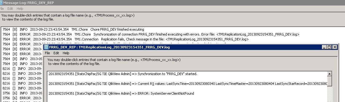

Sorry. I also attached a shot of the error msg. FRRG_DEV is the InstanceA. FRRG_DEV_REP is InstanceB. I executed the chore in FRRG_DEV_REP.
I use the same username password.

How can you "use the same username password" when you are using SSO? What ID did you specify for the replication ID? I'm pretty sure you can't use an AD account for the replication ID. You probably need to use mixed mode and specify a TM1 user ID and password for your replication ID. I've never tried to replicate using SSO but from what I know about TM1 I highly doubt it will work. I'm pretty sure you need to use a local TM1 account for the replication ID.bunchukokoy wrote:I use the same username password.

Hi Tomok, yeah I mean both accept my Windows account.
Now I see. It should be set to mixed mode first.
Thanks Tomok.
