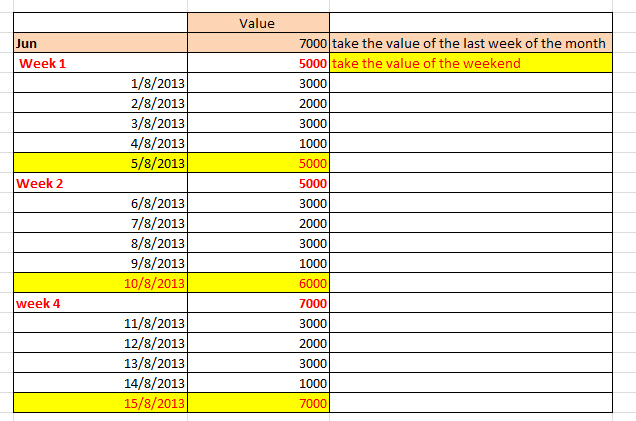

Hi everyone
I have cube , i using cognos insight connect tm1. I want to take the weekend, the last week of the month. How do ??? Get the value as shown in image
thansk all

ChauBSD wrote: I have cube , i using cognos insight connect tm1. I want to take the weekend, the last week of the month. How do ??? Get the value as shown in image
Are you purely using insight or do you have access to the rules editor? (be it through perspectives or performance modeler)
If you can change rules and dimensions etc you just need to add a C-level rule and decide how you will specify which day is looked at for a given week.
Assuming it has just built 1 time dimension for you in the exact format below you may want to add in a string attribute to the dimension called "week_last_date" (name purely for example, call it whatever you want.)
['Value']=C:
        If ( Attrs ( 'Time', !Time, 'week_last_date' ) @<> '',
                DB ( 'Cube', !Dim1, Attrs ( 'Time', !Time, 'week_last_date' ), 'Value' ), CONTINUE );
Another option would be to create an extra dimension that only consisted of the "Week" elements from your time dimension and then having the attribute in there.
['Value']=C:
        If ( Dimix ( 'Week', !Time ) <> 0,
                DB ( 'Cube', !Dim1, Attrs ( 'Week', !Time, 'week_last_date' ), 'Value' ), CONTINUE );
Both are using the same concept.
You could also use the Elcomp/Elcompn functions to find the last element in the consolidation but be very wary about this as elements could move etc.
Performance Modeler does have some built in calculations you can apply to time dimensions, not sure if there is one to do exactly this but it could be worth having a look.
Edit - I didn't specifically mention the "Month" part of the rule but you can extrapolate the above to cover that.

I have 2 dimension
+ Dimension time : Consolidate year, Consolidate month, element date
+ Dimension Value: element value
I want get date last of month. How do. Can yous say again. I can't update weigth property element.
Thanks all
Re: get the value date of the weekend and the last week of t
Assuming that all time dimension rollups are laid out and indexed in chronological order. (It is a big if but not half so big an if that users only want to ever see weekend data roll up)
Then you can just use: ElComp( 'Time', !Time, ElCompN( 'Time', !Time ) )
but having an "ending date" attribute is generally by far the safer and more recommended approach: AttrS( 'Time', !Time, 'End Date' )
