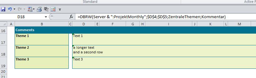

I have some trouble with editing textfields in excel as well as in TM1Web :oops: and therefore several questions. I know a database I can't compare with e.g. MS Word, but I am still missing some functions to use textfields. Please see the simple example in the attached file. It's an Excel-file, I only have 3 textfields, the contents I catch by TM1-DBRW-functions.
1) If I once have inserted a text, is it possible to edit this text (changing, updating, adding) without typing the hole text once again ?
2) column D to M are connected. Is there any chance to get the "optimal" line-height ? (if I enter 4 or more lines, so that everything is displayed)
3) is it possible to copy text (which is e.g. edited by notepad or word) to my fields without deleting the dbrw-function ?
4) is it possible to save text-formattings (bold, italics or something else for a PART of the contents) in the textfields ?
5) Inserting a linebreak in textfields within TM1Web seems to be not possible ? Does anybody know more about this "feature" ?
Thanks a lot in advance

Newcomer wrote:1) If I once have inserted a text, is it possible to edit this text (changing, updating, adding) without typing the hole text once again ?
Easy. In TM1web just double-click the cell. In Excel F2 followed by F9 and edit text
Newcomer wrote:2) column D to M are connected. Is there any chance to get the "optimal" line-height ? (if I enter 4 or more lines, so that everything is displayed)
By "connected" I assume you mean merged? If the user interface for end users in Excel you can add a VBA macro to autofit row height after data entry. If web then there's no way as far as I know of, you have to allow enough height in advance.
Newcomer wrote:3) is it possible to copy text (which is e.g. edited by notepad or word) to my fields without deleting the dbrw-function ?
Yes this is how TM1 works. If you paste a value over a DBRW formula the formula isn't deleted the value is sent to the database. The caveat or limitation in Excel is that this can only be done one_cell_at_a_time, for larger ranges the DBRW formulas will be deleted on paste. TM1 web isa better solution for this type of functionality as you can paste as large a region as you want.
Newcomer wrote:4) is it possible to save text-formattings (bold, italics or something else for a PART of the contents) in the textfields ?
No.
Newcomer wrote:5) Inserting a linebreak in textfields within TM1Web seems to be not possible ? Does anybody know more about this "feature" ?
Alt + Enter in Excel. As far as I'm aware this is not possible in TM1web.
