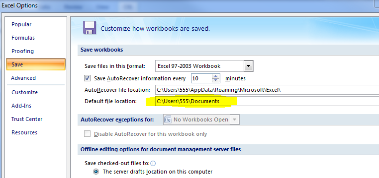

I did download the Microsoft Process Monitor and run it. I could see the "No Such File" error/event type; however to solve the problem your are supposed to assigning appropriate write permissions to the path set in "Default file location" which it doesn't seam to take any effect.

The Excel default file location shouldn't be where the .xdis are saved anyway; it should be in the data directory specified in your TM1 Options. In any case, saving them into your personal Documents library would be bad voodoo. They should be in a folder on the server; if not the actual server data directory, certainly one close to it.

In terms of the program files directory it is all in good order (thanks for sharing that post thought) also my data directory in my TM1 options is pointing to the right folder in the server where all the xdi files are saved I have nothing saved in my documents library.
