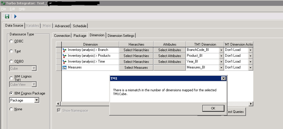

Hello all
I am trying to load data from a Cognos package (a cube in Powerplay) into a TM1 cube.
I have installed the TM1 Package connector and it works!
I can import all dimensions, but only the measures cannot be selected: if I click on "Select Measures", I get an empty list.
As I cannot select any measure, I have no data at all in my cube :-(
Does anyone have advice on this one? I verified that the measures exist (there should be 6 measures in the Measures dimension), using Powerplay. I add 2 pictures on the TM1 part.
Thanks in advance!

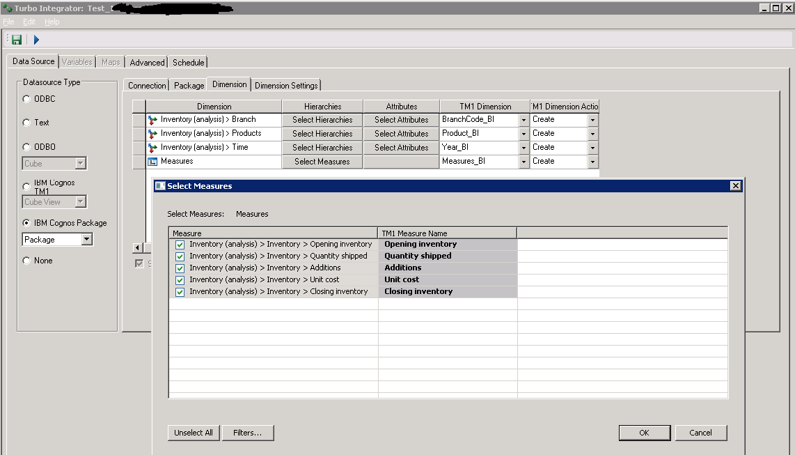

Posted: Mon Oct 07, 2013 1:50 pm
by theblackdawn
Well.
I was trying to do something similar - Loading Data from a Cognos Package into a TM1 Cube.
But to my surprise, I was able to select the measures and everything was correctly placed.
But Again... :roll: I was NOT ABLE to select another dimension as a Measure Dimension to which the data should load into.
This screenshot shows that the measures can be selected.
But we need to add another dimension as 'Measure' dimension to which the data should get loaded. Am I right here?
And the Package Connector does not allow to add a new dimension, like the way we add in the Variables tab (when loading from a csv or ODBC) when a dimension count is less.
Any suggestions or help appreciated here.
Kindly correct me if my approach itself is incorrect.
