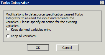

You would only lose the variables if you had a vague moment and clicked on keep derived variables only and then saved changes to the process. Otherwise nothing will change with the saved variables.
The OP is talking about a situation of migrating from D to P. In a production system there should be no need to preview datasources, or for that matter to open TI processes in edit mode. So really whether the data source preview window is populated or not shouldn't be of any consequence or concern.
Yeah an unknowing admin could refresh the variables and save the process with no variables, but then should such a person have admin rights in the first place???
