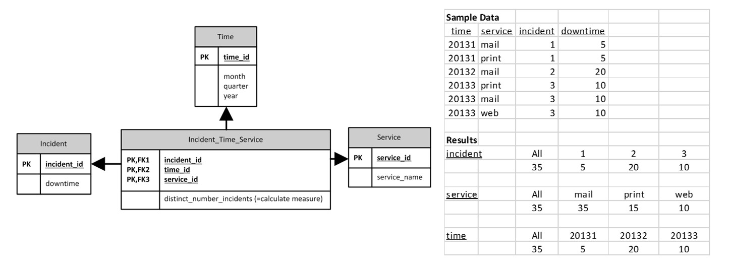

I try to give you some additional information. I attached a sample model, some sample data and desirable results. Hopefully it illustrate my issue a bit more.
As long as a measure (e.g. downtime) rely on one incident_id and one incident_id can affect more services i have a summarisability problem.
As far as i know a star schema layout is not capable of doing this.
Many thanks for any hint!
