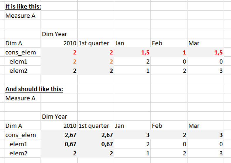

i have a problem with the consolidatedavg function and hopefully anyone could help me to deal with it.
I have a sample cube with three dimensions. I attached a picture to demonstrate my problem.
1. Measure A should be consolidated as average along the time dimension, but shoul be consolidated as sum along the third dimension.
My rule looks like:
['Measure A'] = C:ConsolidatedAvg(0, '', !DimYear, !DimA, 'Measure A');
2. The average consolidation should consider 0 values as well. I read that it works with the parameter "0" in the above function. But it didn't.
Any hints would be wonderful. Thanks!

I've never used this function before but a quick perusal of the documentation makes it clear that if you don't want the average computed for a particular dimension you have to specify a fixed node in that dimension that the rule should apply to. If you use the bang notation (!), for a dimension then the function will consolidate for that dimension. In your case you used !DimA so it is being averaged across that dimension. You should have used 'consol_elim' instead. As to the other problem with it skipping zeros, have you tried using 1 in the first parameter instead of 0?sibbi82 wrote:I have a sample cube with three dimensions. I attached a picture to demonstrate my problem.
My rule looks like:

Re: consolidatedavg not at all dimensions?
Thx for a reply!
I changed the rule to
['Measure A'] = C:ConsolidatedAvg(0, '', !DimYear, 'cons_elem', 'Measure A');
But it changed nothing at the result. I tried also to work with the STET function. But didn't get it.
YEs, i tried it with value 1. But that didn't work neither.
Probably it was not clever to place two problems .... I would appreciate to fokus on my first problem, that makes me much more headache...

The hint with the if Statement solved the issue for me. I did it that way:
['Measure A'] = C:
IF(
DTYPE('DimA',!DimA) @= 'N'
,ConsolidatedAVg(...)
,STET
Additionaly i had to change the dimension order in the cube, to get the right sum in the C nodes of both dimension ...
