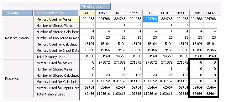

For completeness it would also help if you turned on performance monitoring, waited a couple of minutes, and then included a picture of a portion of your }StatsByCube cube - like the one below.

Please find the snapshot of statsbycube
I am having two test cubes Reserve and Reserve Margin, both are working fine with simple rules, but as soon as I link a rule to read a data from a complex cube it stops caching.
I have set the following properties
VTM = 1; VMM = 4GB; CalculationThresholdForStorage = 5
- statsbycube.png (16.49 KiB) Viewed 17625 times

So what happened between 0M00 and 0M01? At 0M00 the Reserves cube had saved calculations and at 0M01 it didn't.
What happened between those times to invalidate the cube? Did someone write a cell, or change one of the dimensions? It might be worth checking in the transaction log.
