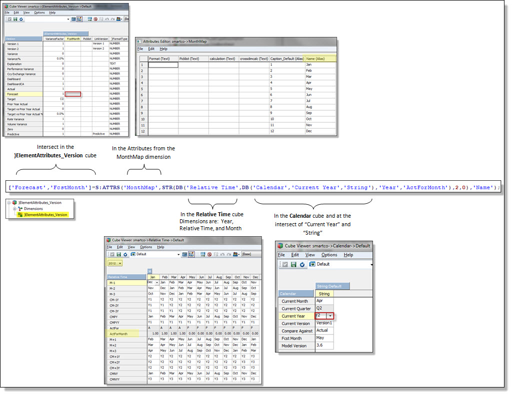

Hey guys
I was taking up someone's suggestion in another thread of mine on just looking through rules in a sample library provided by IBM and trying to understand them and kinda got stuck :( I tried to draw it out (I am very visual if you haven't gathered that yet) :shock: and then peice together what this rule is doing in an attribute cube...
The rule is:
['Forecast','FcstMonth']=S:ATTRS('MonthMap',STR(DB('Relative Time',DB('Calendar','Current Year','String'),'Year','ActForMonth'),2,0),'Name');
And below is the visual so you can literally see each cube / dimension it's referring to from this sample library. I think I need to do something similar in a Months attribute cube I have built is why I am looking at this specifically. I was hoping someone could put in layperson's terms what this rule is doing?
Thanks so much!

Re: Attribute Rules Explanation for Version?
Just expand it from the inside out e.g.
= 'Y2'
Then:
DB('Relative Time', 'Y2' ,'Year','ActForMonth')
= 4

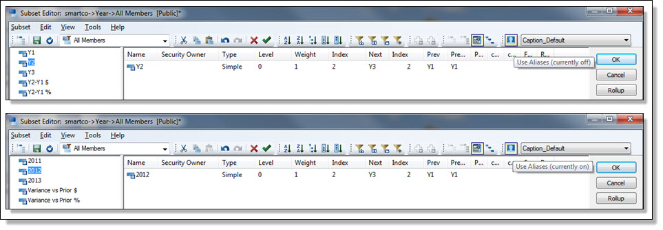

(I am assuming that there is an element in the months dim called "Year" which is a total of the months, 4 of them that I can see have 1's in) Although where you have "2012" selected is there also a "Y2" option or is "2012" an alias of "Y2"?
Then:
STR(4,2,0)
= '4' (string instead of numeric)
Then:
ATTRS('MonthMap','4','Name');
= 'Apr'
Obviously that required a bit of assumption on my behalf in the middle that might be wrong but even if it is you could follow the same logic, applying what you know to be correct and get an outcome accordingly.

Thanks a lot Declanr!! Yes, your assumptions are correct!!
I guess time and experience will help to make it easier :) Now I need to reverse engineer (in a way) to accomplish what I am trying to do...

Oh - and here are screenshots of the dimension so you can see the alias on and off :)
Year Dimension.jpg (91.29 KiB) Viewed 4311 times

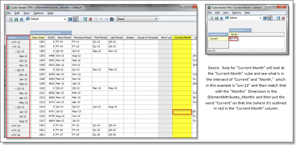

Here is my real life example. Where I seem to not have grasped yet is how to match something in one cube to something in another cube. I have an extremely strong back ground of Cognos Analyst and I am still trying to cross that mindset into TM1 with rules, etc. Thus, why i am struggling yet. Once I grasp a concept, then I tend to run with it. I am still trying to grasp at this point, which is frustrating (and requires patience)... I know conceptually of what I want... which is what I describe in the screenshot... but getting there is where I am struggling. :oops:
Thanks for any help anyone can provide at helping me understand how to accomplish this... or the mindset of how to think through it logically in order to write the rule to accomplish it. My hope is that I will eventually grasp, run with it, then be able to help others at some point versus just always being the one asking for help. :oops:
Current Month Example.jpg (160.69 KiB) Viewed 4309 times

I THINK I am on the right path :) Not quite there yet... The code is working, but not exactly 100% accurately. What it's doing is putting "Current" in EVERY cell in the "Current Month" column.
['Current Month'] = S:
		 IF(DB('Current Month', 'Current' , 'Month') @= DIMNM('Months',DIMIX('Months', DB('Current Month', 'Current' , 'Month'))) ,
		 'Current' ,
Where, I only want it to say "Current" on the month that is listed in the "Current Month" cube, which is currently "Jun-13"
jimicron wrote:I THINK I am on the right path :) Not quite there yet... The code is working, but not exactly 100% accurately. What it's doing is putting "Current" in EVERY cell in the "Current Month" column.
		 'Current' ,
You haven't included anything that will cause the formula to vary based on what cell intersection within the cube you are looking at (e.g. a ! ref)
What you are saying in your rule is:
Working on the right hand side of the "@="
= 'Jun-13' (it will always be Jun-13 regardless of what position in the cube you are at)
DIMIX('Months', 'Jun-13')
= 6 (probably not actually 6 but that's irrelevant, it will be the dimension position of the element Jun-13)
DIMNM('Months',6)
= 'Jun-13' (this just converts your dimension index back to an element name, so the last 2 steps combined will do nothing other than add some memory overhead)
So with the last 2 steps cancelling each other out, you may as well have just had
= 'Jun-13'
Then you take that result and compare it to the left hand side:
= 'Jun-13' (which is exactly the same as your right hand side)
So your left hand side is the same as the right hand, you may as well be saying IF 1 = 1 DO SOMETHING..... 1 will always equal 1
Perhaps try something along the lines of:
If ( !Months @= DB('Current Month', 'Current' , 'Month'), 'Current Month', '' );
Think of it in a similar way to when you were first introduced to simultaneous equations in school and you can keep cancelling parts of the equations out until you get down to the core components.
