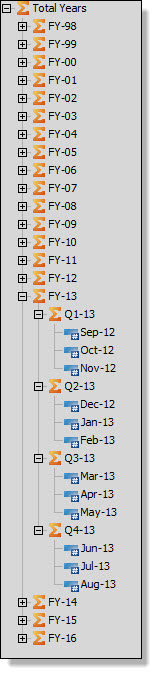

We do not use the typical time dimension in the sense that it's embedded in our company to concatenate Mon-Yr versus separate Month vs Year dimension.
I have a bunch of attributes for this dimension and I also need to add "Previous Period," "Next Period," "Last Period," and "First Period."
Is there a way to do this via Rules in the Attribute cube for my months dimension? (versus just manually populating every month, quarter, and year)
The Index for the dimension is like this which poses challenges as well :(
Total Years (Index: 1)
FY-98 (Index:2)
Q1-98 (Index: 3)
Sep-97 (Index: 4)
Oct-97 (Index: 5)
Nov-97 (Index: 6)
Q2-98 (Index: 7)
etc.
I'm just trying to make this as automated as possible with rules. Thanks a lot!!

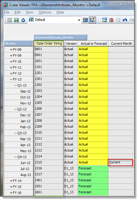

Now, I want to say, for the 'Actual or Forecast' column, populate 'Actual' from the 'current month' all the way back otherwise, populate with "Forecast".
That way, they will populate a 'Current Period' cube each month simply with the current Mon-Yr and everything will feed off that. They won't have to go in and update "Actual or Forecast" (and I have about 20 more columns that will populate automatically if I can get this understood. Me and another coworker (we are both green and painfully learning slowly) have looked at this all morning and are coming up empty handed (we've been close) so I finally decided to post. I want to always make a diligent effort to get this on my own before posting so when I post, it's a last ditch effort. I greatly appreciate any assistance!! Thanks a lot!!
Actual or Forecast Months Logic.jpg (134.6 KiB) Viewed 18693 times
jimicron
Posts: 110
Version: 10.1.1
Excel Version: 2007 SP2 MSO
Location: Boise, ID
Re: Months Dimension (Previous Period & Next Period)
Post by jimicron »
In rereading this, not sure I am clear. Still struggling with this after many attempts to do this various ways.
In the screenshot above, it appears that I have it figured out, but I do not. I have manually typed Actual or Forecast in the "Actual or Forecast" column. However, I'd like to do that via a rule driven off the "Current Month" column.
So, what is in Yellow and Green, I'd like to populate with a rule based off "Current Month" but using "Date Order String"?
Thanks again!

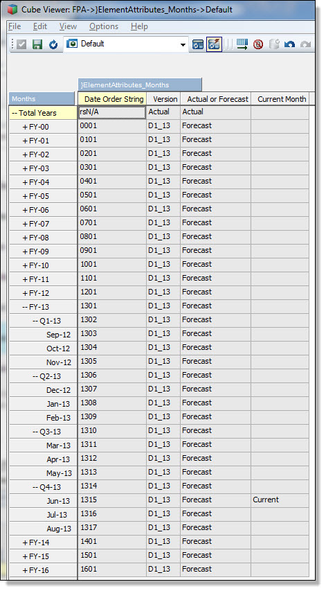

I tried the code that you gave... it works without an error... however, "Total Years" has "Actual" and all the rest have "Forecast" ?
['Actual or Forecast']=S:
		 IF ( NUMBR ( ATTRS ( 'Months', !Months, 'Date Order String' ) )
	 	<= NUMBR ( ATTRS ( 'Months', DB ( 'Current Period', 'Current Month ID', 'Period' ), 'Date Order String' )),
		 'Actual',
		 'Forecast' );
Thanks for your patience!
Months result.jpg (174.42 KiB) Viewed 18669 times
Control Cube.jpg (21.26 KiB) Viewed 18669 times

When I do this only:
['Actual or Forecast']=S: ATTRS ( 'Months', !Months, 'Date Order String' ) ;
It takes the string that is in the "Date Order String" column and puts it in the "Actual for Forecast" column.
Thus, 'Sep-12' has '1303' in both columns, 'Oct-12' has '1304' in both columns, etc.
When I do only this:
['Actual or Forecast']=S: ATTRS ( 'Months', DB ( 'Current Period', 'Month', 'Period' ), 'Date Order String' );
I get '1315' for every month in the 'Actual or Forecast' column b/c my 'Current Period' is 'Jun-13' and the 'Date Order String' for 'Jun-13' is '1315'
In the syntax Declanr gives, I know then it's taking the NUMBR of each (when i do them individually, I have to just take the string since my column is string, not number).
I can't quite figure out why it's giving me 'Actual' for "Total Years" because by doing that, it's telling me that it's meeting the first condition and I don't see how 'rsN/A' is <= '1315' .... that's what is confusing.
Why are you using this:
In your code instead of this:
(which you did however use to prove your theory)
Have you tried right clicking on a cell and tracing calculations? It looks like the "Current Month ID" part of the calculation was coming back to a zero, hence everything being greater than it and being a forecast.
As to the total years "date order string" being an error, is that what you want or can you set it to blank etc? I'm not 100% but if the "Current Month ID" part is evaluating to 0 then I suppose the error for total years could become a zero when converted to a number... then they are both equal, hence "actual".
jimicron
Posts: 110
Version: 10.1.1
Location: Boise, ID
Post by jimicron »
Hi Declanr!
Thanks a TON for your help!! That actually resolved it. :D
What was I using "Current Month ID?" Well, :oops: , that was an accidental remnant of our troubleshooting yesterday. We did all sorts of things that I didn't even mention in the forum to spare the details. I accidentally copied over the wrong code that exposed that. Sorry about any confusion that may have created.
I think this just showed that we needed to step away because we had focused on this nearly all of yesterday and we missed an important little thing. Once I put it to what you gave, voila, it worked!!
I'm not sure why others haven't replied to this thread but I really really really appreciate all the help that you have provided!! We are very grateful for your assistance b/c it's been very helpful! Once we see how to do something once, we can then utilize it in other places. We still have one big hurdle to conquer, but this was a great one to conquer as well.

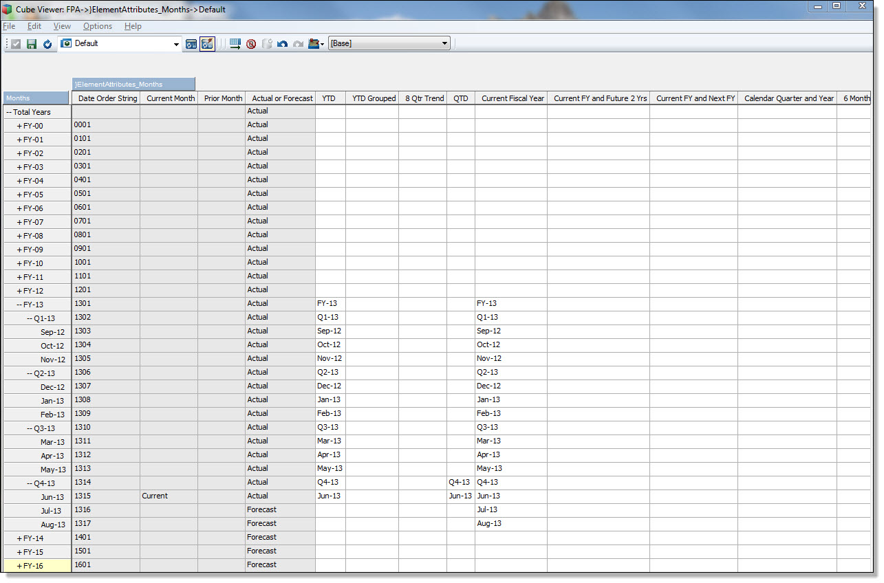

There is more than meets the eye on this month dimension. Yes, typically, you can just populate once per year and I agree. What I was attempting to do is something similar to what we have in PowerPlay where we have all sorts of alternate hierarchies such as:
* Current Closed Period
* Prior Closed Period
* Current and Prior Closed Period
* Current Quarter
* Current Fiscal Year
* QTD
* YTD
* YTD Grouped
* Current FY and Next FY
* Current FY and Future 2 Years
* 8 Quarter Trend
* Future 2 Years
* Current Qtr and Previous 3 Qtrs
* 6 Month Trend
* 12 Month Trend
* 6 Month Trend and 12 Month Future
* 6 Month Trend and 6 Month Future
* 6 Month Trend and 24 Month Future
* etc.
* etc.
Thus, I was trying to derive all of those based on my simple 'control cube' that had "Current Period" in it and the end user would simply input the Mon-Yr (ie Jun-13) that was current and then my rules in the Months Attributes cube would then populate all those attributes I list above based on that one month. Since almost all of those above will roll on a monthly basis it would be quite a bit to have an end user update all of those attributes monthly.
I'll attach and image below so you can see a little bit. All the columns that are white, I am trying to create rules so they will all populate and roll based on what month is current. I have manually populated three columns (YTD, QTD, and Current Fiscal Year) just so you can see what I was hoping to populate the columns with. After these were all populated, I was going to create "Alternate Hierarchies" based on each of the attribute columns (I already have done that succesfully in other models and have the code for it).
Right or wrong, that is what I was trying to accomplish and why I was trying to do so. :oops:
Months Attributes Goal.jpg (266.95 KiB) Viewed 18457 times

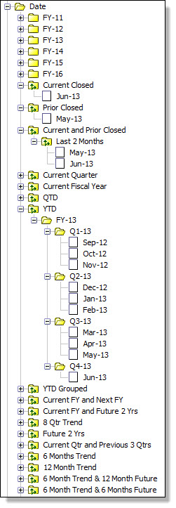

Here is a screenshot of the PowerPlay hierarchies that I was trying to replicate
PowerPlay Hierarchies.jpg (88.29 KiB) Viewed 18457 times
