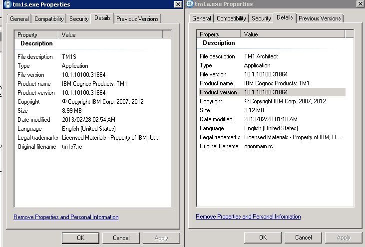

I've attached a screenshot of the tm1s.exe and tm1a.exe to see the client and server properties - they match. I've also tried using the ClientVersionMaximum=10.1.10100 parameter to match this version but then I get the error "User does not have permission to browse the selected server" - and I've googled that error too without to much success.

- TM1.jpg (89.01 KiB) Viewed 7474 times

No, unfortunately it's still a problem. I'm trying to restore other TM1 instances to see what the difference is but to answer Steve's question:
I am not using a shortcut, I'm actually navigating directly to the C:\Program Files\ibm\cognos\tm1_64\bin\tm1a.exe file to run this to make sure I'm using the correct executable. This was installed at the time I reinstalled TM1 which was an installation of server and client components so I don't see how the server and client can be out of sync?
This version of TM1 is a windows version and it's running on servers at the clients site (same file versions for tm1s.exe and tm1a.exe) and the data directory that I've restored is also from the clients site so this should run...?

problem solved!
When I read the IBM article to verify client and server versions I just used the tm1s.exe file but I'm not running these instances as applications, they're running as services. To get better visibility into what process is spawned by what service we usually copy the std tm1sd.exe to say, tm1sd_ABC.exe for the instance ABC. Then when this instance's service starts we can see in the processes tab which instance it is...
I had a few of these tm1sd executables for running the various services and when I upgraded TM1 the new tm1sd.exe arrived in that folder but the service was still being run by the older (but not yet removed) tm1sd.exe so it was a different version... been scratching my head over this for hours but it dawned on me when I went to try a new instance from the client and went to create a new tm1sd executable and saw the different file sizes across the two versions of Tm1...
thanks for the posts!
