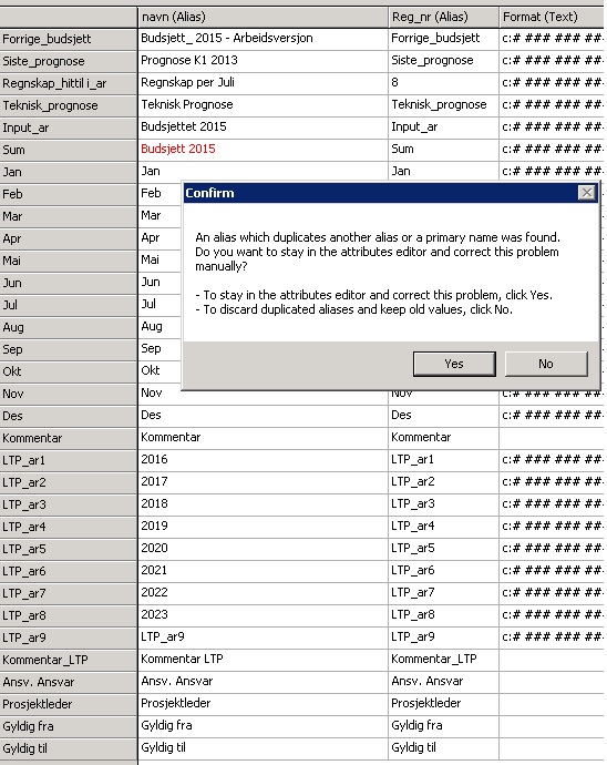

Hi.
Tried what you said, but cant get it to work.
When i try to manualy edit in the element attributes i get the message in the attatchment.
what does that mean?
Can`t see that i have duplicates ?
- example.JPG (147.04 KiB) Viewed 12857 times

Re: Alias not unique (TI)
Are you trying to change the value of the alias?
If so then you may be being caught out by an alias that is still in use by another element. Consider the following simple dimension:-
Element - Alias
Year1 - 2012
Year2 - 2013
If I wanted to increment one year forward then you might try this in the attributes editor:-
Year1 - 2013
Year2 - 2014
However this would fail because until all of the changes are committed 2013 is still associated with Year2. If this is what is affecting you, then you will first need to clear all of the attribute values before attempting the update.
I have seen problems with aliases being cached. When you did as I said, did you destroy the alias? Try destroying it then complete a data save and rebuild it. I would however check very carefully to see if you have any alias / element names that are the same as what you are trying change before taking such a drastic step. If you still don't get any joy, try recycling the service which will for sure clear any cache,
