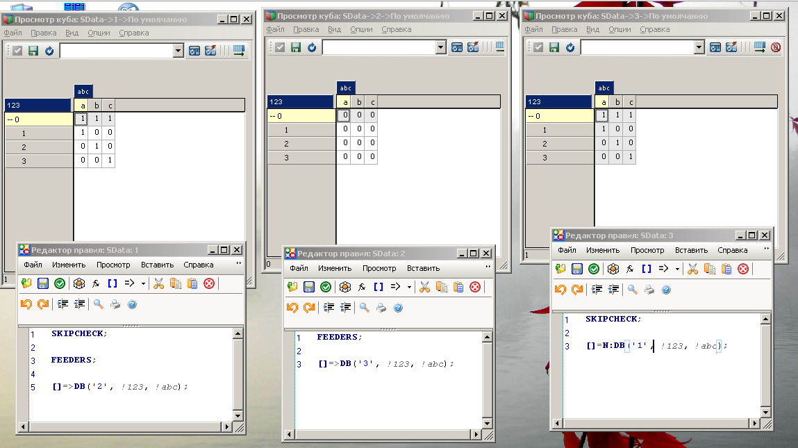

(Identical cubes '1','2','3'; dims '123' and 'abc'; feeder from 1=>2, 2=>3; rule 1-->3)

I'm a bit lost as to exactly what is trying to be done here but just one point of note:
You are trying to feed "Cube 3" from "Cube 2", "Cube 2" itself doesn't have SkipCheck enabled - this won't work.
Although it seems a bit odd since "Cube 2" itself has no rules, in order for feeders from "Cube 2" to another to work, you need to have SkipCheck enabled before your Feeders.
Hopefully that might help with one little issue, even if it doesn't deal with the whole thing. (Obviously also a cube needs to have values to be able to feed something else.)

Re: Feeder Question
ioscat wrote:tomok,
what do you mean at "chaining feeders together"?
The example you posted is a perfect example. The original values, meaning actual data, is stored in Cube 1. You then have a feeder in Cube 1 that feeds the corresponding cells in Cube 2. This places a "marker" in those cells in Cube 2. However, since you don't have actually have a rule in Cube 2 to pull the values in, they never display. Regardless, they have been fed. If you click on one of these cells in Cube 2 and chose Check Feeders, you would see that they have been fed. Now, you have a feeder rule in Cube 2 that feeds Cube 3. The cells in Cube 2 that have been marked (fed from Cube 1), as well as any original data entered into Cube 2, will feed Cube 3. Since you actually have a rule in 3 that pulls in data from Cube 1, the values display AND have been fed, not because they were fed from Cube 1, but because they were fed to Cube 2, which then fed them to Cube 3. This is "chaining" of feeders. As you can see, it can be extremely confusing and should probably be avoided if at all possible.
