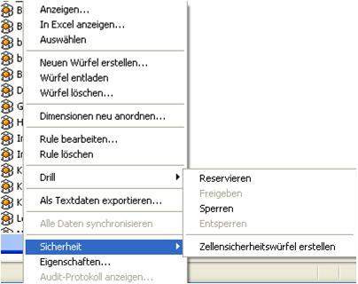

You may check if the cube is locked, or if someone has reserved this cube.
Right mouseclick on cube and then security\lock & reserve. (Sicherheit\Sperren & Reservieren in german version).

Right click on the cube to check for Security settings. Reservieren = reserve; Sperren = lock
