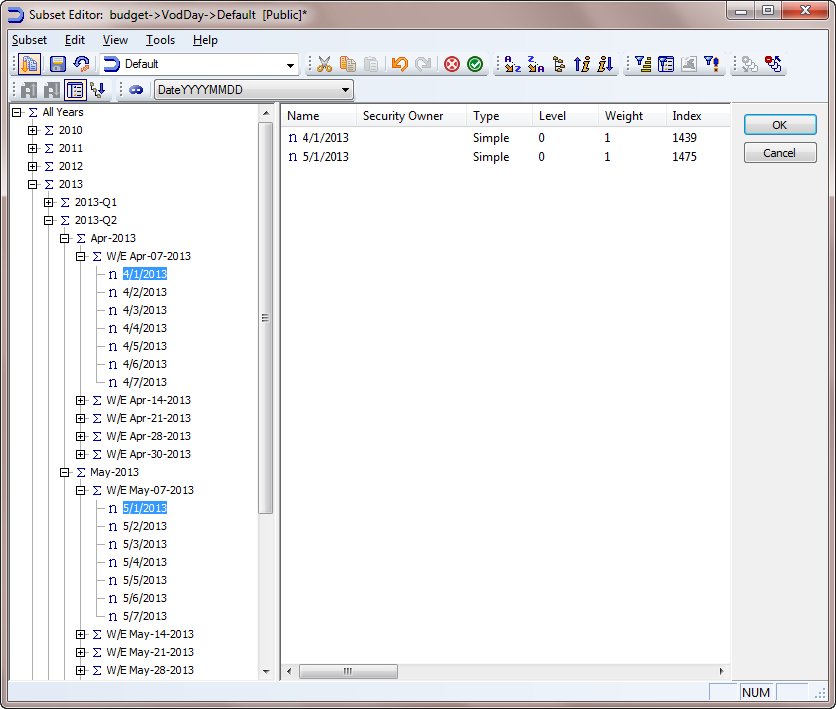

The Process works when all dates are in the same month
Start Date: 4/1/2013
End Date: 4/30/2013
The Process will fail if any of the dates are from a different month:
Start Date: 4/30/2013
End Date: 5/1/2013
This will return all 30 days in April and 31 Days in May
Why would this fail? The elements are contigous and are from the same level?

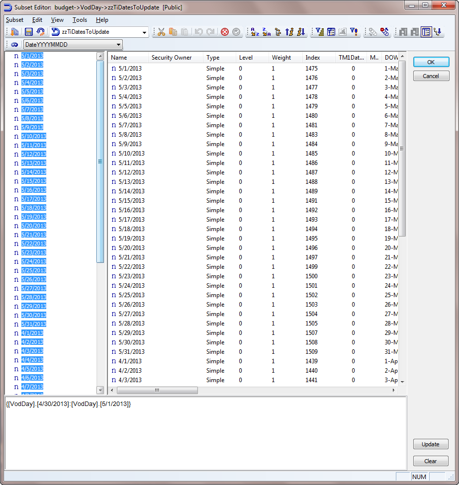

Thanks for your help. There is no error message. Probably the best way to see that the MDX does not work as expected is to use the 'Expression Window' to view the generated subset:
You can see that we used the data range 4/30/2013 to 5/1/2013 but the data returend is all elements from 4/1/2013 to 5/31/2013.

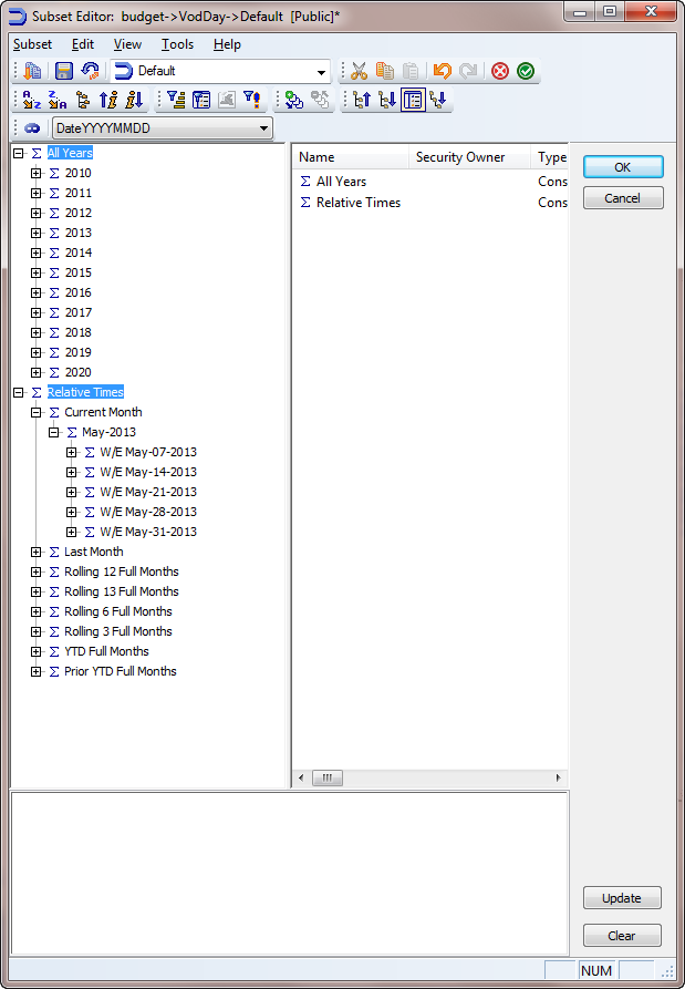

Re: SubSet for Date Range - MDX
I think the issue is that there are 2 hierarchies in the VodDay dimension. One for All Years the the other for Relative Times
