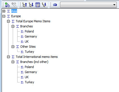

I have created a sample entity which contains only few elements and attached it to my replay.
The attached screen is showing the hierarchy before applying the mdx statement and after updating.
As you can see the all of the elements are doubled.
