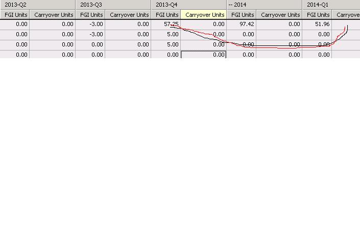

I am trying to write a rule that should apply after certain quarter. Say I have 3 years forecasting from 2012 - 2015. But a certain condition, my rule should apply only after 2013-Q3.
My Rule:
['Carryover Units'] = DB('ORAM', !Scenario, !Company, DIMNM('Quarter', DIMIX('Quarter', !Quarter) -1 ), !Product, 'FGI Units', !ORAM_m);
I want to start this rule apply from 2013-Q3.
I tried this for testing but not working:
['Carryover Units'] = IF(
DIMIX('2013-Q4', !Quarter) > DIMIX('Quarter', !Quarter)
, 100
, STET
Can you correct my logic?

Re: Rule to Fix a Quarter going forward
Pretty basic
should be
DIMIX('Quarter', '2013-Q4') > DIMIX('Quarter', !Quarter)
I doubt you have a dimension called '2013-Q4'
However for this sort of logic you are much better to 1/ not use Dimix and 2/ not have hardcoded constants in the rule
For 1/ hold incrementing index values against each quarter in a time lookup cube and test the index value
For 2/ the trigger period should be an attribute or sting value in a control cube somewhere
should be

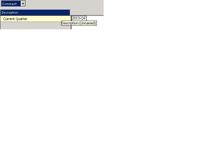

Yes, I dont have any such Dimensions.
My Rule:
This is the rule that should apply after current quarter, current quarter value specified in the control cube. Please attach. So i have changed my rule to:
['Carryover Units'] = N: IF(
DB('Control Cube', 'Comment' , 'Current Quarter')> DIMIX('Quarter', !Quarter)
, 100
, STET
My Rule:
, 100
, STET
- error.JPG (11.05 KiB) Viewed 4931 times
Does something look strange? Well it should because you're trying to compare a string to an integer. I'm not going to write you a rule, you can think about it yourself.kkmk wrote:IF( DB('Control Cube', 'Comment' , 'Current Quarter') > DIMIX('Quarter', !Quarter)
rozef
- Posts: 74
- Joined: Thu Jun 17, 2010 10:35 am
- Version: 9.4 9.5.1
- Excel Version: 2003 - 2007
You should lookt at NUMBR function. That must be enough to solve your issue.
