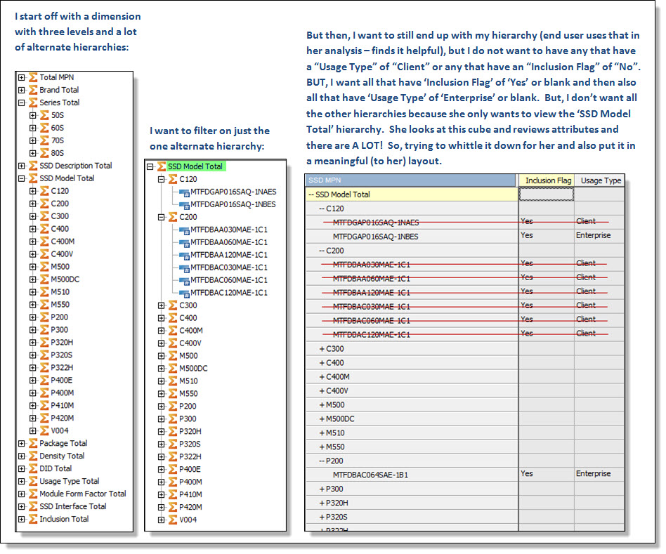

Thought I would post an image to help clarify :) I have tried various recordings and then tried to "fit it in" to the code above but must be missing something. I wasn't trained on understanding the order in MDX or anything so that's why it's a bit more difficult to understand at the moment. Here is a visual though that I hope is helpful. FYI - there are a LOT more attributes to the right of "Inclusion Flag" and "Usage Type".. I just kept these two in to help simplify and since it's the ones I am filtering on. Thanks again!
Desired Subset Example.jpg (280.75 KiB) Viewed 10791 times

You realize, of course, that including the hierachy in the subset, and then filtering out some of the children is going to be highly confusing. For example, using your screen shot, any cube value shown for C120 is still going to include MTFDGAP016SAQ-1NAES, even though you've filtered it out of the subset. Filtering the display of children of a consolidation does not change the underlying definition of the consolidation. This is going to be true for any of the consolidated nodes where you have filtered out some of the children.

But in seriousness, this would be a subset that is ONLY used in this cube that has all these attributes. So, no harm. It's filled with a ton of attributes and not any numeric sort of values. The dimension IS used in a financial cube, however, the end user realizes that she woudln't use it in that cube. It's just for her analysis of the cube with the attributes.
However, you did make me think that maybe I'll see if she minds not having the hierarchies... and just sort on the "SSD Model" column... then, all those that are the same will be next to one another. I am going to try that now :) Thanks for the input.

jimicron wrote:what it is doing is bringing in all the hierarchies and not just the one that I want.
Then the answer is to not use TM1SUBSETALL({dimension}) but use DESCENDANTS(some_hierarchy):
