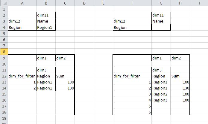

I put a sceen from Excel that I want to see

I have Cube with some dimensions one of them (dim_for_filter) contains elements:
1, 2, 3, 4, 5, 6 ....
Region
1 Region1
2 Region1
3 Region2
4 Region3
5 Region1
6 Region2
I want to filter data in this Cube (choose some elements from dim_for_filter) if data from one of elements in measure dimension (Region) is the same as choosing in Cube 2 (cube for choosing Regions)
So if User choose Region1 in Cube2
he will recieve in Cube 1
Region
1 Region1
2 Region1
5 Region1
But if user doesn't choose anything in Cube 2 he will receive full list of elements
Region
1 Region1
2 Region1
3 Region2
4 Region3
5 Region1
6 Region2
I want to do it using MDX expression to dimension dim_for_filter

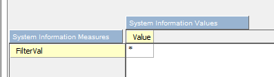

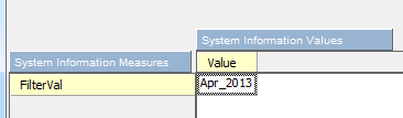

To demonstrate my suggestion I have set up a simple parameter/control cube.
I will use this to filter values in a simple time dimension "Time Monthly"
Derived from the code sample I posted earlier:-
TM1FilterByPattern(
		TM1FILTERBYLEVEL(
			{TM1SUBSETALL( [Time Monthly] )}, 0
	, [System Information].([System Information Measures].[FilterVal], [System Information Values].[Value])
I get (not surprisingly) a single result "Apr_2013".
If I then put "*" in the parameter/control cube:-
And use the above MDX to filer my time dimension again, I get all of the zero level elements.
As I understand your question, this would seem to cover it.
