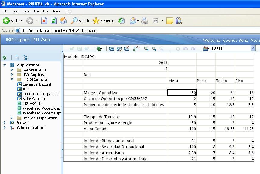

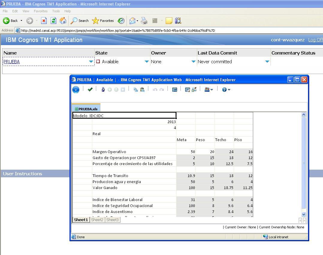

I have created a tm1 websheet and i have publish it. It works fine in TM1 WEB, TM1 PERSPECTIVE, the cells are enable to edit the data and values are ok, but when trying to open it in TM1 application Web, cells seems to be blocked, the background of the cells are grey and I can not edit anything.
the opcion for write back is enable.
This problem was describe before by other user but no one found solution.
https://www.ibm.com/developerworks/comm ... 0014932943
Thanks.
See the attachment for reference.
Websheet in TM1 APPLICATION not enable to edit data
- grayed cells. Values blocked
- 3. Application.JPG (122.16 KiB) Viewed 4752 times
- enable to add or edit values
- 2. Tm1Web.JPG (89.12 KiB) Viewed 4752 times
- Enable to add values
- 1. Perspective.JPG (79.45 KiB) Viewed 4752 times

yes, i have try that. nothing happen to these cells.
If you see the image of application, you will see first row is available to write, but the rest of cells are blocked. all of these rows have no rules, so i dont understand.
