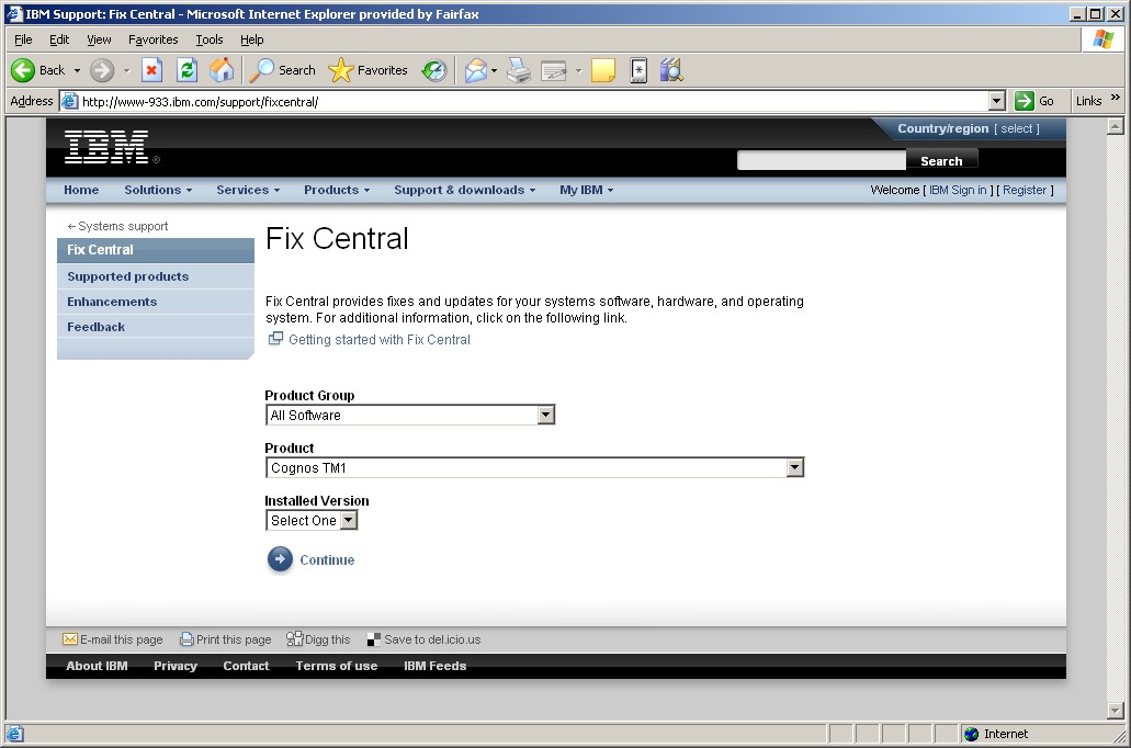

IBM has introduced a new method for getting (some) updates for TM1, though apparently this will be for current / future releases only. Fixpacks, which include fixes only but not new functionality (but see [1] below), can be downloaded from Fix Central. The web page is illustrated below.
The path (http://www-933.ibm.com/support/fixcentral/) is rather less than intuitive (and, given IBM's rather less than linear server naming structure, liable to change), so if you can't find it (or this post) in the future, just do a search for the expression "Fix Central" from http://www.ibm.com. I found it as the second entry when doing a search with the "Worldwide" (rather than "Australia") button selected.
The only release on there at the moment is 9.4 MR1 FP1.
You don't need to log on to Fix Central to get these patches, but since they include fixes only you DO need to already have the full version (in this case 9.4 MR1) already installed on your server.
