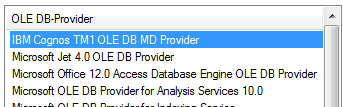

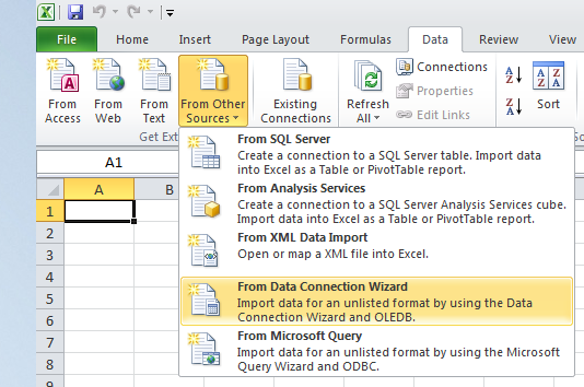

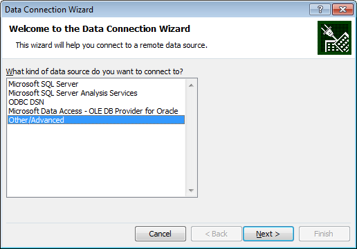

any progress on that issue? I've managed to use the "IBM Cognos TM1 OLE DB MD Provider" to recieve a list of available cubes in the TM1 model. However, when trying to request cube data from the connection, it always fails.
You may google for this driver name and will find some information on parameters, options, AuthenticationMode=5, even connection strings. The driver is available when selected as component during TM1 installation. See screenshots below for an example on how to access the driver, once successfully installed.
