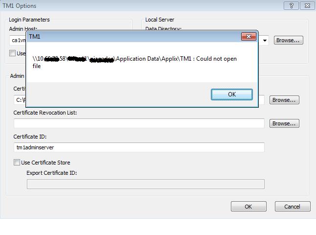

I have installed TM1 client in my CITRIX- Enhanced VDI, But while connecting to the Admin Server I am getting error 'Could Not Open File'.
I have attached the error screen. How to resolve this issue?

Re: Could Not Open File
I suspect that a) the network share in the error dialog is also the one in the 'Data directory' textbox in the 'Local server' settings and, b) you don't have access to that share.
If you are connecting to a remote TM1 server (per the settings in the admin host) then you can just simply delete the entry for 'Data directory'. You will only need this if you are planning on running a separate local server, or developing in XDI or XRU files in your system. In the latter case, you will need to organise access to the file system area that those files live in.
I tried connecting TM1 client through citrix for few users and it was successful at the same time failed for two users.

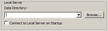

Make sure your Local Server settings look like this:
- Screen_02.jpg (7.1 KiB) Viewed 2954 times
