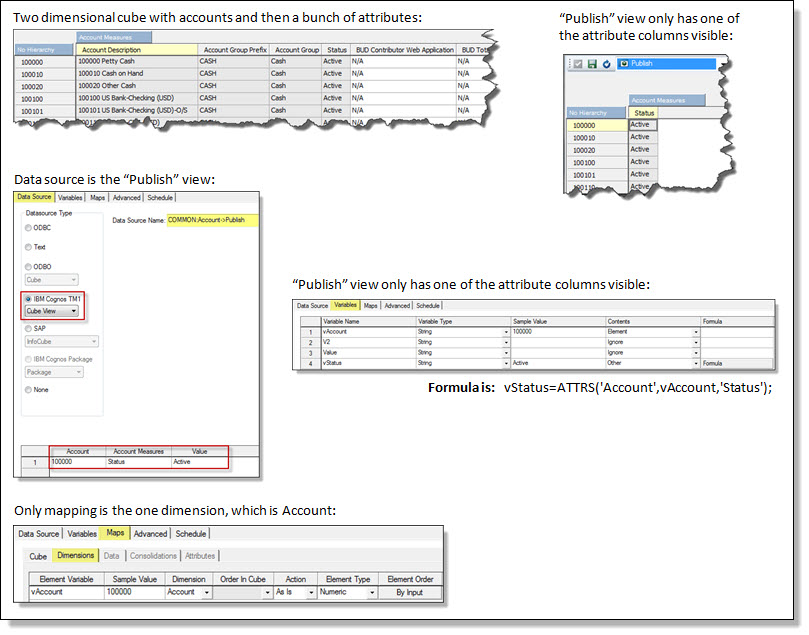

Here are screenshots of the cube and process to provide some insight:
And here is the code:

If you don't get any error messages in the log, meaning the process ran successfully, then the only reason I can think of that the SQL INSERT isn't happening is that the process is not getting any records from the source view. Unfortunately you've left off the most important screen shot which would be the configuration of your view. The screen shot of the view data looks greyed out (the "Active" value) which smells like a rule populated attribute. If that is the case is view zero-suppressed and if so, is the cell fed? Unfed cells would be missing from the data source when the process is run. If they are all unfed then nothing at all would happen on the Data tab.
