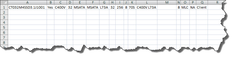

The process runs without error, but when it's done and I look at the .csv, there are no headers :(
And, there is only one line of data :( The cube has about 400 lines in it so I need those 400 lines.
Here is what it looks like:
Thanks again for guidance!!

Where are the code statements that are supposedly going to write out the header? The only ASCIIOUTPUT statement I see looks like it is using variable values to output. To write out headers you would need a separate ASCIIOUTPUT statement inside the IF condition.
IF (Header = 1);
    ASCIIOUTOUT('\\file path\SSD MPN Export.csv','Header1','Header2','Header3'............
ENDIF;
ASCIIOUTPUT('\\file path\SSD MPN Export.csv', vSSDMPN, vInclusionFlag, vSSDModel, vTotalGBperSSD, vModuleFormFactorPrefix, vModuleFormFactor, vDID, vDensityperIndividualNANDGb, vTotalGigabitsperSSD, vTotalNANDDie, vSeries, vSSDModelandDID, vUsableGBperSSD, vMemoryComponentQuantity, vProductSubtechnology, vNANDInterface, vUsageType );
Header = Header - 1;

:oops: Thanks!! Didn't know that. That other thread didn't mention that. So, have added per how you stated putting the column header names in single quotes and voila - worked perfectly!
Thanks a lot for your help! Appreciate it!
