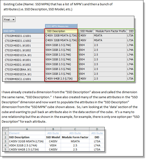

My apologies. I was trying to be discrete on the example b/c of sensitive data, etc. However, I have (hopefully I did this right) uploaded an image that shows the cube that currently exists, a sample of the columns (attributes) and then what I want (need). I think this image will explain everything and leave no more wondering :) Again, my apologies. Didn't mean to make it difficult - was just trying to be discrete. Thanks a lot!
SSD Description dimension example.jpg (224.13 KiB) Viewed 4608 times
Re: Populate Dimension Attributes at different 'grain'
Assuming you are wanting to populate the attributes in the SSD Description dimension via rules, based on the existing attributes in the SSD MPN dimension you are out of luck. The only way to reference those attributes is with the elements from SSD MPN. Since SSD MPN is not in the attribute cube for SSD Description you can't use it in the rule. The SSD Description attribute of the SSD MPN dimension is just a value, it is not indexable or referenceable. There is no function in TM1 where given an attribute value you can determine the element (except of course for aliases which won't work in this case). You could populate a new attribute for the SSD Description dimension called SSD MPN and use that to reference the attribute values from the SSD MPM attribute cube.

You are correct. I AM trying to populate the attributes in the 'SSD Description' dimension via rules looking to the 'SSD MPN' cube.
I know this is a bit redundant and I won't go into the detail as to why I am doing this... but... but just in case it makes a difference... My "SSD MPN" dimension has all the same attributes as what is in my cube. I have a rule that populates the attributes of 'SSD MPN' by looking at the cube. I did this because the end user has an 'override' option so if they do override, I want what they override with to then update the attributes of the dimension b/c that dimension has a lot of alternate hierarchies created automatically based on the attributes.
This is also the reason why i wanted to populate my "SSD Description" cube automatically with rules... b/c then, if they update (override) in the cube... then they would only have to do that override in one place and not also in the new cube. The new cube (dimension) since I was going to use rules would capture their changes.
Bummer. Bummer. Bummer.
But, I will try the other.. but not sure if it will work b/c what if they do the override on the MPN that isn't the one I am using in the "SSD Description" cube... since it's many to one...
Huge bummer. My moving forward was dependent on this working :(
