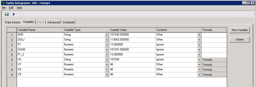

Ran two quick tests this morning using the following functions:
V7=NumberToString(Code(SubSt(AN8, 7,1),1));
V8=NumberToString(Code(SubSt(DGLJ, 7,1),1));
V9=numbertostring(code('.',1));
The first test was without the 'Use Unicode" box selected on the Data Source tab, and this is a sample of the output:
ASCIIOutput('c:\TestCube.cma', V7, V8, V9 );
"0","0","46"
"0","0","46"
"0","0","46"
"0","0","46"
"0","0","46"
"0","0","46"
"0","0","46"
"0","0","46"
The second test was with the "Use Unicode" box selected, similar results.
Unicode box selected on Data Source tab.
ASCIIOutput('c:\TestCube2.cma', V7, V8, V9 );
"0","0","46"
"0","0","46"
"0","0","46"
"0","0","46"
"0","0","46"
"0","0","46"
"0","0","46"
"0","0","46"
When the function is evaluated on the Variables tab, a value of 46 is returned for all three functions. But when the process actually executes, 0 is returned.

Well I think you have your answer then! It looks like when the query is executed there is no 7th character in the date index fields and these are being treated as a whole number with no decimal precision. The issue not that the Scan or SubSt function is working differently between versions but that the variables are being evaluated differently to start with.
I notice that you have an8 and dglj declared as string variables. I would be willing to bet big bucks that these are numeric fields in the source SQL database. Usually I don't care one way or the other but I know that some consultants are very strong on having a best practice that the data source variable in TI should be the same type as the source and then if you need a string variable for TI you declare an extra variable and use NumberToString, NumberToStringEx, etc. I have never really seen a need for this but this might be a case in point where it would be a good idea.
