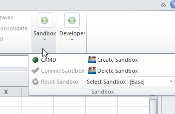

In citrix even as an admin the sandbox feature is disabled in excel
Visible in the server explorer backend but not usable
