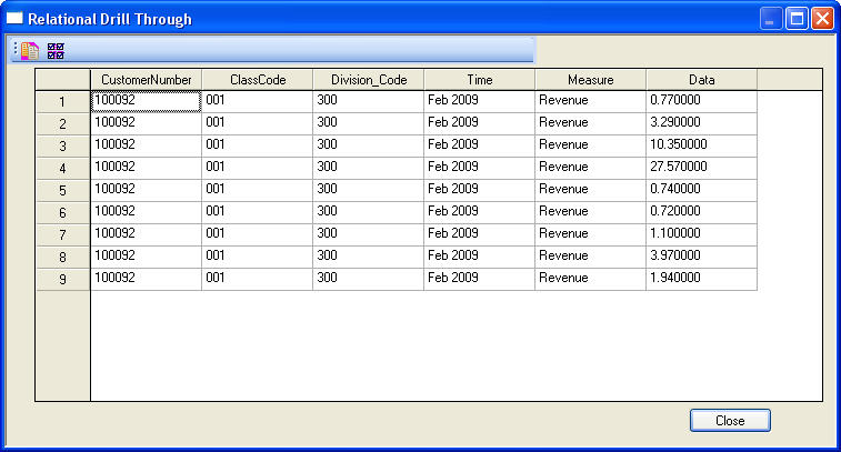

Thanks for getting back to me. Yes, the drill through is working however I am not seeing the mobile field in the output.

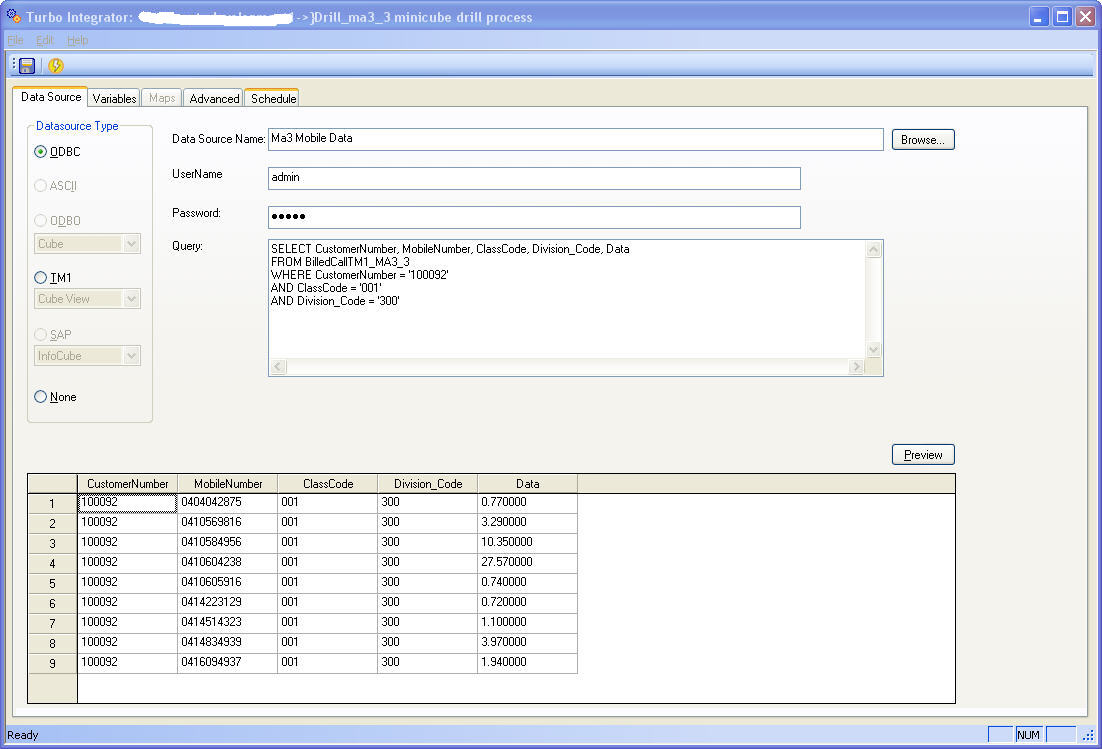

I have ammended my sql to be a little more specific, but still the cube is not drill through is not showing the mobile number field.
YOu make a comment about the "uniqeness" of the records. The customer number is show on multiple recoreds in my access database, with the customer
number having multiple Mobile number customers see screenshot below in "drill through process"

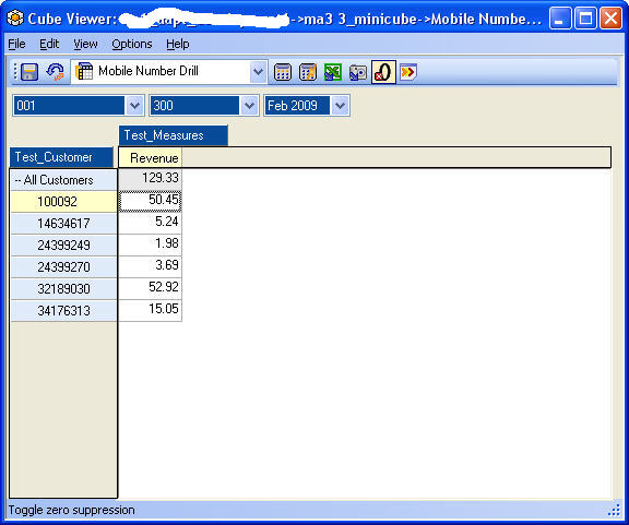

here is a screeshot of my cube that I am drilling down on. note that it does not contain a "Mobile number" dimension:
Still lost as to why I cannot see this filed come through in my drill through ( here is a screen shot of my drill through when I drill down on the cell)
There must be a flaw in my logic / general noobness/ nfi , appoligies if I have missed a point along the way that someone has kindly suggested.

Posted: Mon Mar 30, 2009 6:21 am
by Steve Rowe
Shock,
One thing to check is that you are calling the drill process you think you are. If you have been through several iterations it's possible that you got your wires crossed somewhere along the line?
Other than a bug I can't think of another logical reason why you would be going wrong like this....

Posted: Fri Apr 03, 2009 12:31 am
by shockwave
Thanks Paul,
its working now. There were some other drill processes that appeared to be causing a conflict. Deleted them in the back end and I am able to drill through to the data. Thanks agin for everyone who has helped me, esp cleaning up some of code.
