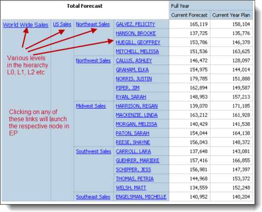

We are migrating our EP application to TM1 10.1.1 Application with approval hierarchy.
We had a very handy feature available in EP - which is explained in one of the proven practice doc in IBM. This feature lets users launch an EP contributor node from Cognos BI reports. See below screenshot
Launch EP node.png (107.96 KiB) Viewed 2398 times
Is it possible to launch a TM1 Application (aka Contributor) node using URL? In developers guide there is a good information on using URL to launch cube viewers in TM1 Web. But there is no section explaining how to do it in TM1 Application! In TM1 Applications guide, there is no mention of URL at all.

Turns out no such feature currently exist for TM1 Application :( ... it's a bummer that we had it in EP and missed out in TM1 Application
This is now logged as an enhancement request. I tried to analyze the HTML code generated, it is invoking code built using dojo toolkit. I couldn't make much out of it.
I'd love to hear if anyone managed to understand the way URL is generated using dojo; or some how had this implemented
