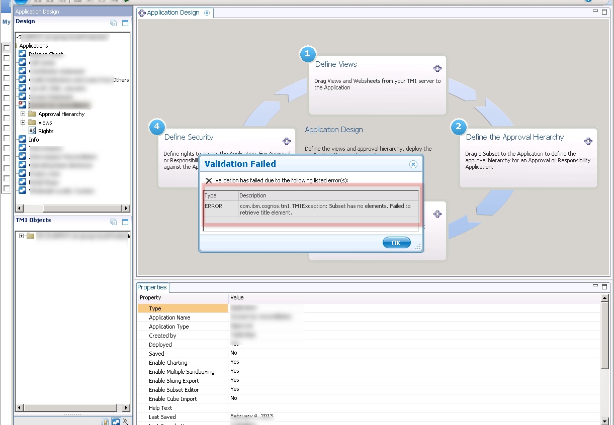

Did anyone get this kind of error. It happend on all applications ,... all the dimensions and subsets have visible elements. I think it happend after links in dimension hierarchy were broken, dimension was updated once again, but we didn't do delete all elements.
Thanks!
title element not found - application validation problem
- error.jpg (246.68 KiB) Viewed 4136 times

Re: title element not found - application validation problem
Extra data maybe. Additional useful information no.
Check for empty subsets.
The error message in the application builder is implying there is a problem with an empty view because a title dimension is empty due to it being assigned a subset that has no members. When dimensions are updated you need to be careful that static subsets don't get cleared. Typically doing DimensionDeleteAllElements is not a very good idea and it is better to unwind without deleting. Put members back in the subset and your issue should be fixed.
But, even if i create new dimension or cube with new dimension i get this error.
Dimension and cube are simple and there is no difference. If I create dimension in TM1 modeler , I get the same error at the time dimension is created. Like I wrote there is no empty subsets and all views looks just fine.
Any other ideas?
Thanks!
Any other ideas?
Thanks!
